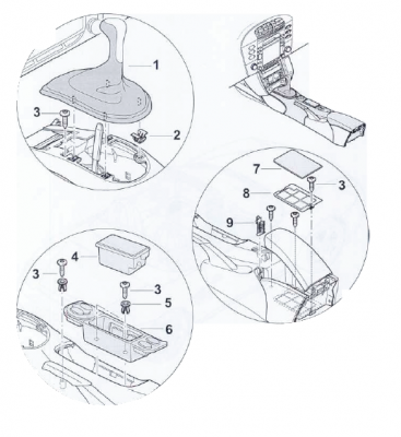

Replacing the center console isn't too complicated, see attachment
Does anyone have this picture in high res? Thank you in advance!
Trieullionaire
LOL - that is as "high res" as Porsche gets in their service manuals.
Trieullionaire
Thank you for the quick reply!
