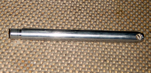

My stupid dealer did not know what I was talking about. So I bought one from MBenz parts. They have 2 sizes (M12 and M14), M14 for ML SUVs.
I saved this image a long time ago and do not remember where I found it.
Is this the Mercedes version of the hanger?
very similar. I can post a picture when I have a chance.

These are more expensive than those in earlier postings.
http://www.ultimategarage.com/wheelhgr.html
over price. even for porsche. It said it's built for strenght, but the key is that the wheel to be mount/dismount has no load, just the weight of the wheel, plus you are only using it for a very short period of time (a few mintues at most). Way over engineered.
