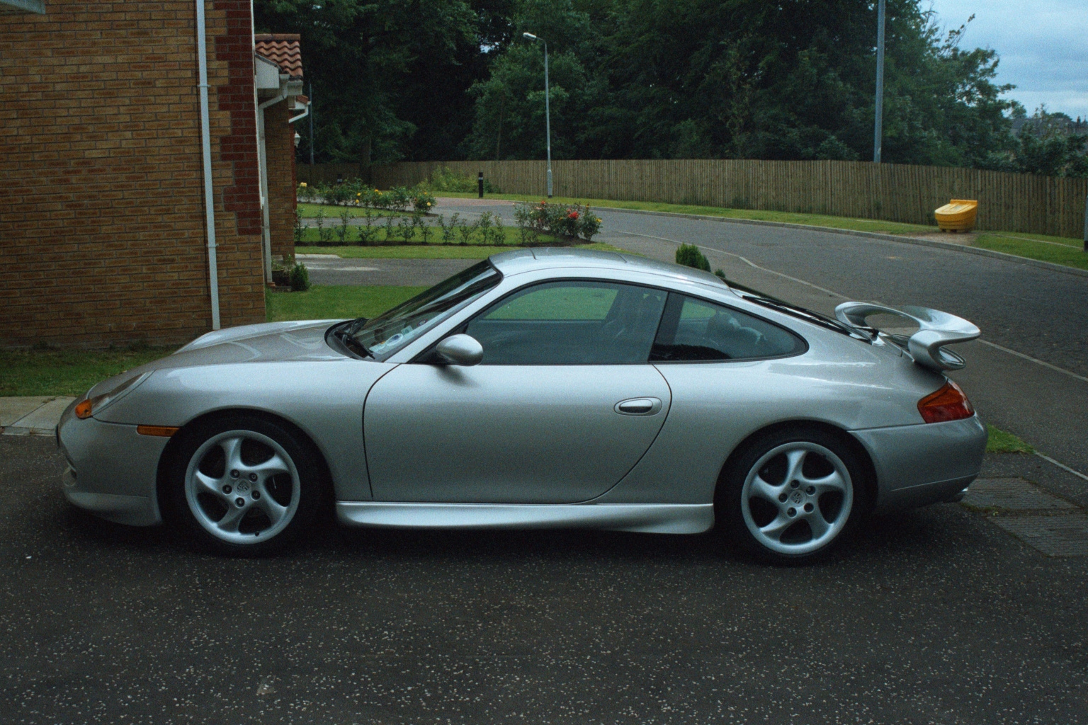

Here is a pic of the wheel, and another of the car I want them on...
My car is a 2000 C4 Cab, 29K miles, Vesuvio....

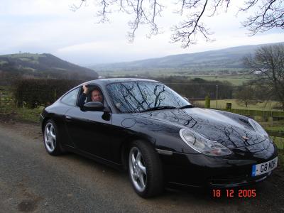

Hi, this is my first post on RennTech.org. My father's ride is a 99 C2 Cab with the turbo wheels. I don't know about the differences in the C4 vs C2 offsets but they're the turbo wheels on a pre-facelift, and in a dark color too.
I hope this helps and if you want I'll get some more pictures of it tomorrow since I'll be home, that picture is from the fall and is a pretty bad angle.

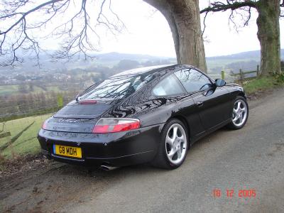

I have the 18" sport design wheels on my 01 C4 - very similar design. As far as I know they are the standard C4 18" size 7.5J x 18 50mm and 10J x 18 65mm. See what you think..........
Sam & Mike, Those Turbo 3 wheels are very similar to the wheels I mentioned, but the C4S or 996 Twin Turbo wheels are slightly different, I had seen some of the C4S (TT) advertised and thought about buying them. Have a look at the C4S in some pics and the 996TT and you will see the rim of the wheel is different even though the spoke is the same, albeit when the spoke meets the rim its different too, much more chunky and deep.
However after seeing your pics, especially yours Mick, I'm sold, I started out looking for your very wheels but saw the others advertised, now I am back where I started they look fantastic Mick, are they new? refurbed? mind me asking are they the originals, what they cost, from who etc etc....
Your car looks stunning! Thats it its those wheels for me! did you have the park assist retro fitted?
Denis
The wheels are the originals as far as I know - only had the car 16 months (pics taken just after I got it). They have one or two scratches round the edges that's all - amazing after nearly 6 years! Have a trawl through eBay - there's usually something similar on there. Alternatively check out www.porscheshop.co.uk they have a decent looking selection.
