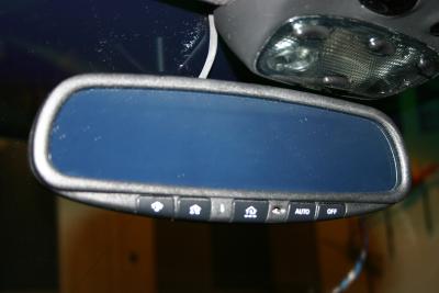

Here is another option. Besides the Homelink, you also get an automatic dimming rearview mirror.

I bought mine on E-Bay. I did a search on Google and found the following:
http://www.aaaremotes.com/aurevimiwiho.html
I am sure there are other places. It works great. I tapped into the switched 12V source in the overhead console area so running wires was not an issue. Easy install. You will not be able to use the standard mirror plug on the windshield. I installed the mirror plug that came with the mirror next to the original one. Unless you are really looking for it, you cannot see it.
Wouldn't you be better off with an unswitched 12V source so you can open the door when you're in the car before you turn the ignition key? Is there an unswitched power source in the overhead console?
There may be a constant 12V. I didn't look for one. I have my Valentine wired into the same source so it was readily available. The self dimming mirror has a light on it and that could be a concern as a voltage draw if the car sat long term.
I normally use the wall switch in the garage to open the overhead door. It has not been an issue for me to have to have the ignition on to use the opener in the car.
