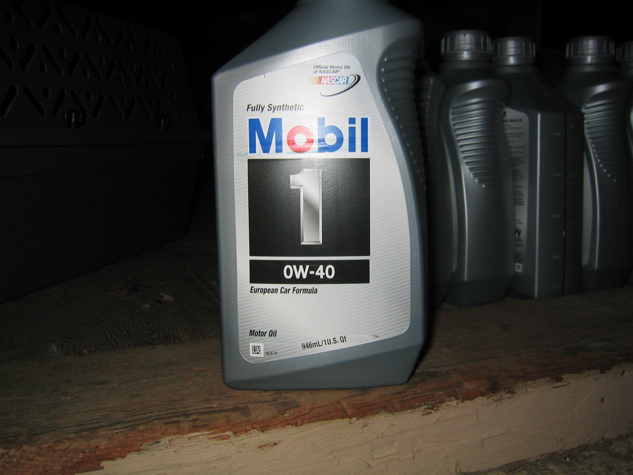

Hello again,
So I found a Kragen that carried Mobil1 0W-40. The problem was nowhere on the bottle did it say "SuperSyn anti-wear technology". I asked a guy there about it and he said don't worry all Mobil1 oils have SuperSyn. Well, I went ahead and bought 9 quarts but now I'm wondering if that guy knew what he was talking about. Is what he said true and so I don't have to worry? Should I take them back and find a place that carries 0W-40 with "SuperSyn" written on the bottles? Attached is a pic.
thanks,
David
So what would I use to top up a MY06 987 then?
thanks!
http://www.mobil1.com/USA-English/MotorOil/Oils/Mobil_1.aspx
This implies that all mobil1 has super syn in it.
Extended has 50% more, but not made in 0W 40,
and not approved by Porsche.
Just get Mobil1 0W 40 and you will be fine, if you would feel better
get it from your dealer.
