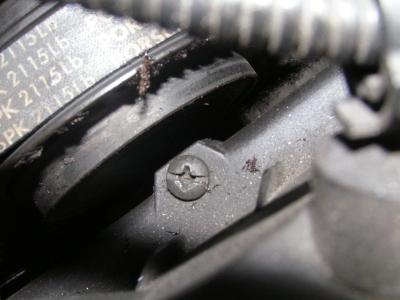

Yesterday on a 200 mile trip I smelled a burning smell in the car after stopping, went to the engine and found small splinter like shards splattered on some of the hoses. Checked everything over and found that it originated from the A/C pulley. The only thing that had changed is That I turned off the climate system. The A/C has not blown cold for sometime but there is no noise, etc. I planned to have the system charged this summer. Can someone shed some light here?

You'll have to remove the belt and spin each of the pulleys/idlers/tensioners to see if the A/C is the problem or just the belt dust accumulating on that pulley. The A/C has two parts..... the actual brng assembly for the belt pulley and the drive for compressor.
the belt is new and shows no sign of wear. This is a completely new thing, believe me if you could smell
it you would never let it become a problem. I know the path you are thinkingabout and I have to say that it is not an issue with the belt itself the picture where you see the pulley you can see the debris coming out from the clutch area of the pulley. I just fitted a new belt and tensioner bearing on New Years, as it (tensioner bearing)started making noise on a road trip 500 miles and within that trip it fell off. Can anyone tell me where to find the warranty specs/ recall tsb's. This is a bit silly for 75kmls

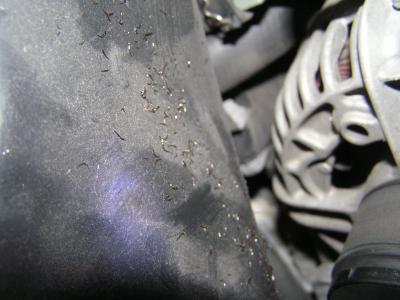

Here is a pic of the debris I am speaking of that is strewn about the bay.

A/C clutch disintegrated would be my guess.
I'll 2d that.
Well I took that to the bank. Thanks guys, I put the order in through Sunset Imports I hope it is as simple as was the tensioner!
I would have to say that the brng in the pulley assembly has failed, it's overheating and melting out the resin from the clutch windings. I beleive you need special tools to replace the brng.
