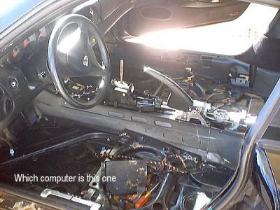

I got a reply that I would need to get my car to run is match the DME, Alarm (imobliser) and key set. The one on ebay is that the alarm on the lock assy? or is it under the drivers seat as in my picture?

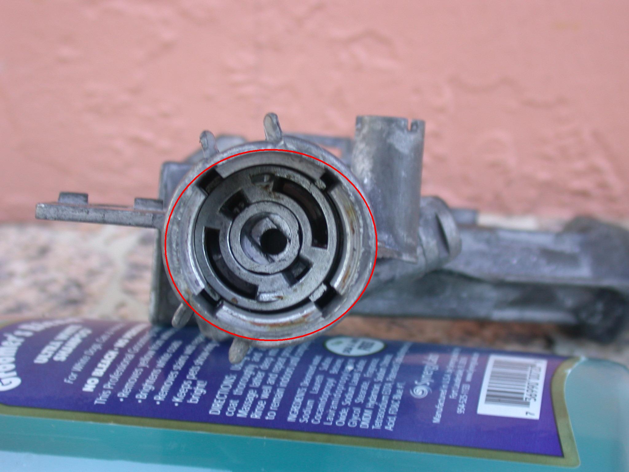

Wanted to post the pic on the other forum you are posting but was not able to.
Try turning it with a screw driver the part inside the red circle.
It could be that the real switch is broken so try removing the actual switch at the end of the assembly.
I thought that also so I removed the switch with no change but, I'll give a big screw driver a chance at the electrical side tomorrow. :thumbup: Or I and have it towed to a bad part of town and wait for a theif to pull the key lock out. :) Edited by Mother

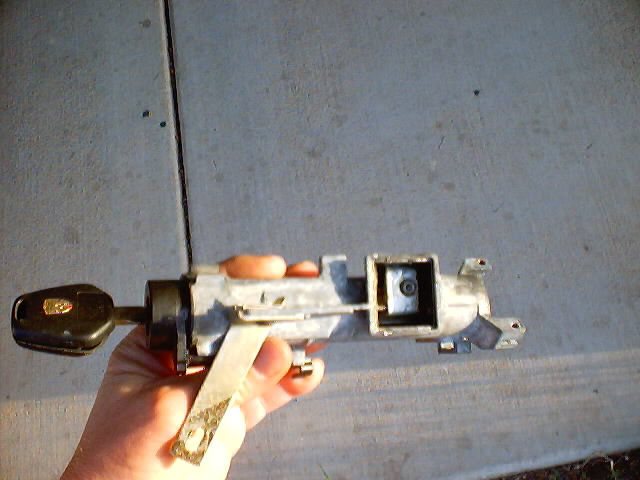

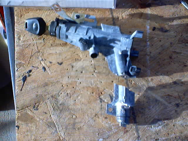

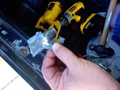

Ok Finally lock assy is out and new one is in. :clapping: Called a locksmith and the key turned about 1/8 to the right, but not to the 1st detent which told him it was not the tumblers and lock was ok. Next day he showed up with a cutter and cut the lock in half mind you he was not sure what he was doing either but at this point I just wanted it out! Well with the cut part off we popped off the lock assy plate and saw that it was binding in there and could not free it up. Well next step when you cut it off there is nothing to grab on to, to turn. and the pin would still not depress. :cursing: Next and last resort <_< a heavy hammer and screw driver and beat the sh**t out of it as it goes into the steering column hitting away from the column direction and it still would not come all the way out but to my surprise I could see part of the pin so we drilled there tring to get part of the pin on the lock which worked and came out with a couple more big "waaaaaks" with a hammer. :thumbup:. Well I paid him took about 35 - 40 min and as he left said he probably won't be doing any more Porsches LOL.

OK~! Jolly Jokers, I do have to watch what I take pictures of, The door sills are removed and being polished and I need to do some paint touch up work. ;) I heard you ask what am I using to polish with...You guessed it Mothers! :thumbup:
