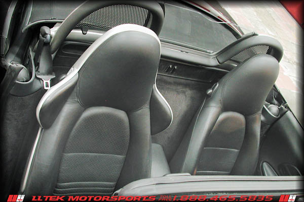

I am wondering what it would take to convert a standard seat over to a sport seat. Is it possible to just replace the seat backs? The seat base does not look any different between the two units. Apart from that there does not seem to be any more room to have a wider seat base.

Part numbers are confusing (to me, anyway), but it does not appear that you can. None of the part numbers for the different seats are common.
Thanks Don. I was hoping I can change just the seat backs. I do not believe it is a viable option to change the whole seat over. Especially with what it would cost to get them either locally or even from the US.
Regards
Arthur
Arthur: The seat back is the only difference between the "sport" and standard seats but AFAIK Porsche does not sell the base and the back seperately. You could ask Gert at carnewal.com if he can provide them though. I would strongly suggest sitting in a car with the sport seats before swapping them out on your car. Personally I don't find them more supportive than the standard seats but that could be because the "wings" hit me right in the shoulders. Strangely enough the GT3 seat, which I'd call a real sport seat, fits my shoulders fine.

Do you know much about that kit? It looks rather interesting and possible solution ;) I will be giving them a call later on tonight if not first thing in the morning - a few hours time difference unfortunately.
If I were to go down the porsche parts path, am I to assume there is quite a number of parts that form the seat back?

Don't know anything about the kit, but I have seen it on US ebay a few times.
Porsche does not sell the seat back as an assembled unit. There are a lot of individual parts.
Too bad you cannot try the sport seats because you may not fit in them for the reason previously stated.
You can just swap backs and it works...I sold a set os sport seats to a fellow board member on 6speed who did just that...I guess he now has the only full electric sport seats WITH memory in the US :eek:

hey Arthur,
just stumbled over this, might be an option for your question of Sport seat conversion.
LLTEK is the company which offering this.
