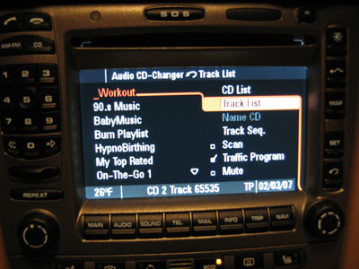

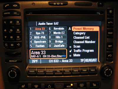

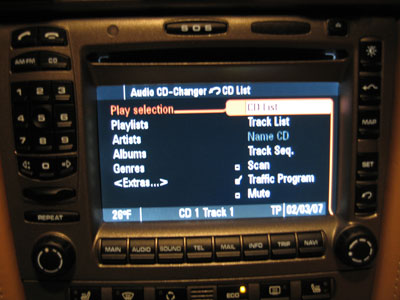

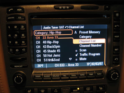

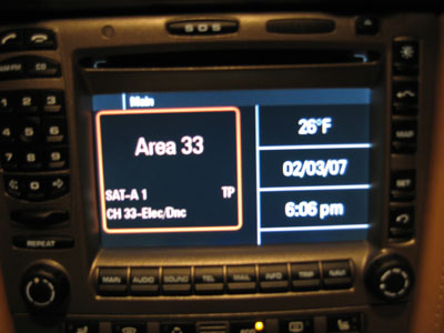

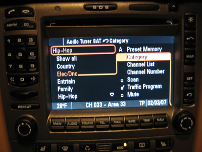

Some pics of the updated 997 PCM with the addition of the Sirius sat radio inteface + the iPod functionality replacing the CD Changer interface below.
Damon
