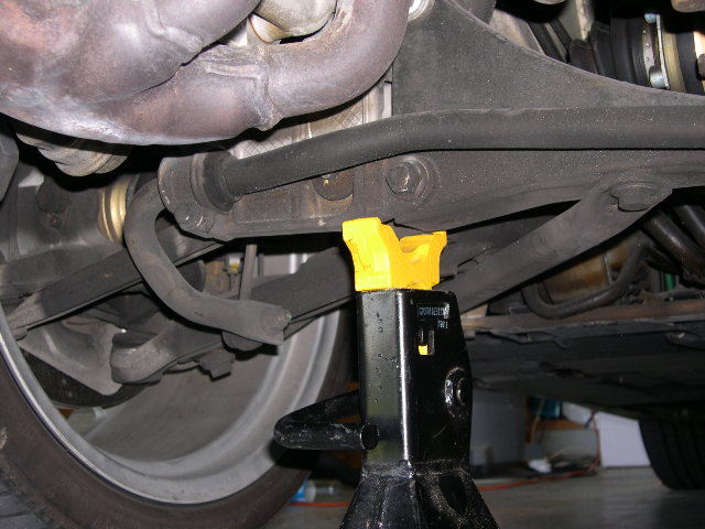

Is it possible to jack the entire rear of the car [996TT] from the "lug" at the forward end of the engine cases that has a steel jacket bolted to it? It seems to be a natural place to put the floor jack and take the whole car up and then put the jack stands under the rear suspension. Thanks, Peter

I jack my car from the main rib of the engine casing (further back from where you're suggesting), this area is a very strong part of the engine. This has been debated many times, and is a common way of doing it. I support the car on jackstands either at the jacking points just forward of the wheels or the suspension crossmember carrying all the suspension parts.
I wouldn't put a jack to any of the actual suspension pieces, I'd be afraid of bending something.

I think that the part that the original poster is refereing tois the engine arrestor (stops the engine moving far in an impact.
I've been told that this point is the best lift point by a VERY reputable GT specialist in the uk.
I've used it myself plenty of times.
