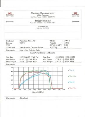

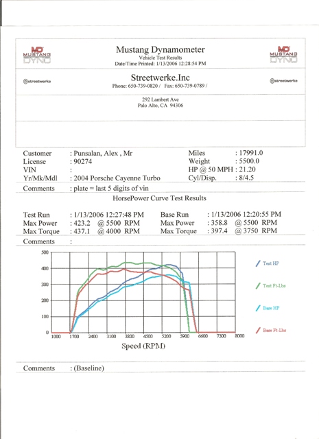

Here is an example, assume 25-27% transmission loss on the numbers.

I have done the dyno thing as I do with most of my "upgrades". With the Fabspeed I lost 12.35Hp and 15.26 lb-ft.
