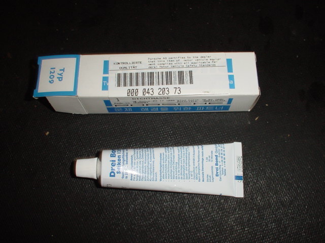

Here's the parts list. Can anyone explain the "window adhesive"?
It is a silicon sealant used for such things as the oil pan. When I saw it being used the mechanic told me it was also used for the windshield.
