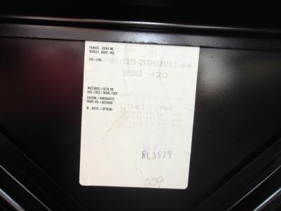

There is currently on fleabay, an '05 NON 'S' but with the X50 engine. The engine code for this X50 car (M9670-645) post-22209-1205856655.jpg
is the same as the first post here. So, does that mean that in fact the 'S' is the same as the X50 (which is what I understood)?
Just curious, does anybody happen to have a GT2 engine code from '05???
edit - actually, I note that in an earlier pic in THIS thread, the X50 engine there DOES have an X50 option code. This particular engine does NOT have the same X50 option code, but it does have the same 'engine code' as the first post here for the '05 Turbo S car with the X50 engine. So now I'm really confused.

That car is a not a "Turbo S".
It does have the X50 engine package. Please check the 2005 TT order guides (that you can download here) for the differences.
M96.70-645 is a 309KW (420HP) engine.
The G96.50 is the standard 6 speed TT transmission.

See, this is where I get confused. BOTH cars had the 6 spd even though they have different transmission codes (well, the last 2 numbers anyway). But BOTH cars have the SAME engine code, and you've indicated that this car, while not an "S", DOES have the X50 engine. It should therefore not be 420 HP but rather 444 hp (or 450 or 462 or 483 if it's the same engine as the "S"). Hey Loren, I'm not trying to argue this one way or the other, just trying to figure it out. If you're getting the HP ratings from the engine code, shouldn't this non-S be the same HP as the "S" (Same engine code?). If you're getting the HP rating some other way, please enlighten me. Thank you.
Thanks Loren. I still don't get why different engines have the same engine code, but I suppose the VIN would be the most accurate tell tale. Without actually seeing it for myself, who knows, maybe that code sheet wasn't even for that car.... :P
