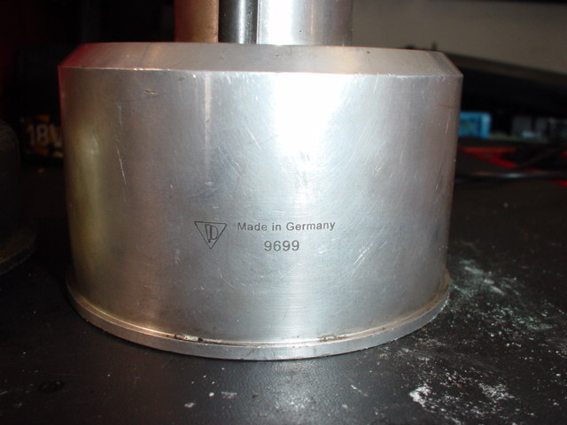

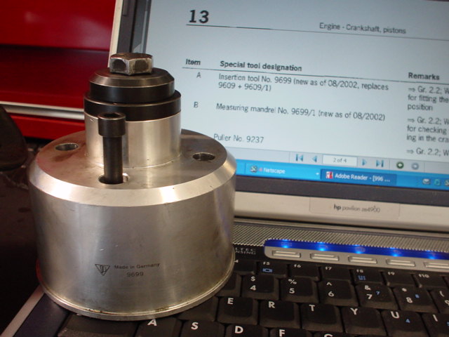

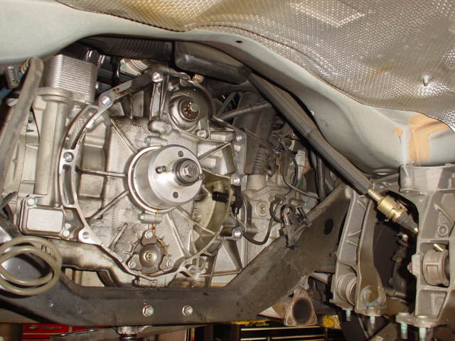

What is the up to date part # for the special tool for installing the 997 101 212 00 seal ( I believe this is the latest)in a 986 S MY 2001?
When I saw a 997/Cayenne style seal being put in an older 986 last year it was the same tool that had been used for a few years. I do not know of a special tool for the 997 seal, but I have not asked in a year.
