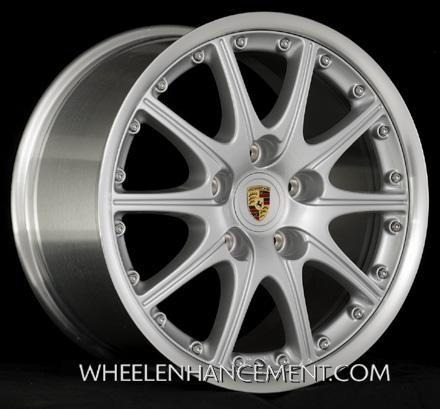

Those are twp piece wheels and the outer rim is not painted - nor are the bolts. To paint it properly the wheel needs to be disassembled, painted and then re-assembled with the proper torque sequence on each bolt (IMHO).
Loren is correct. The outer lip is not painted, but it is clearcoated. It would be very difficult to paint those wheels properly with them assembled.

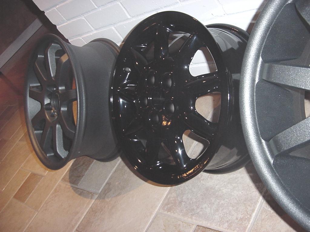

btw, i ended up painting the wheels black.
heres a few quick pics, came out great and held up very nicely, i used the rustolium high temp paint

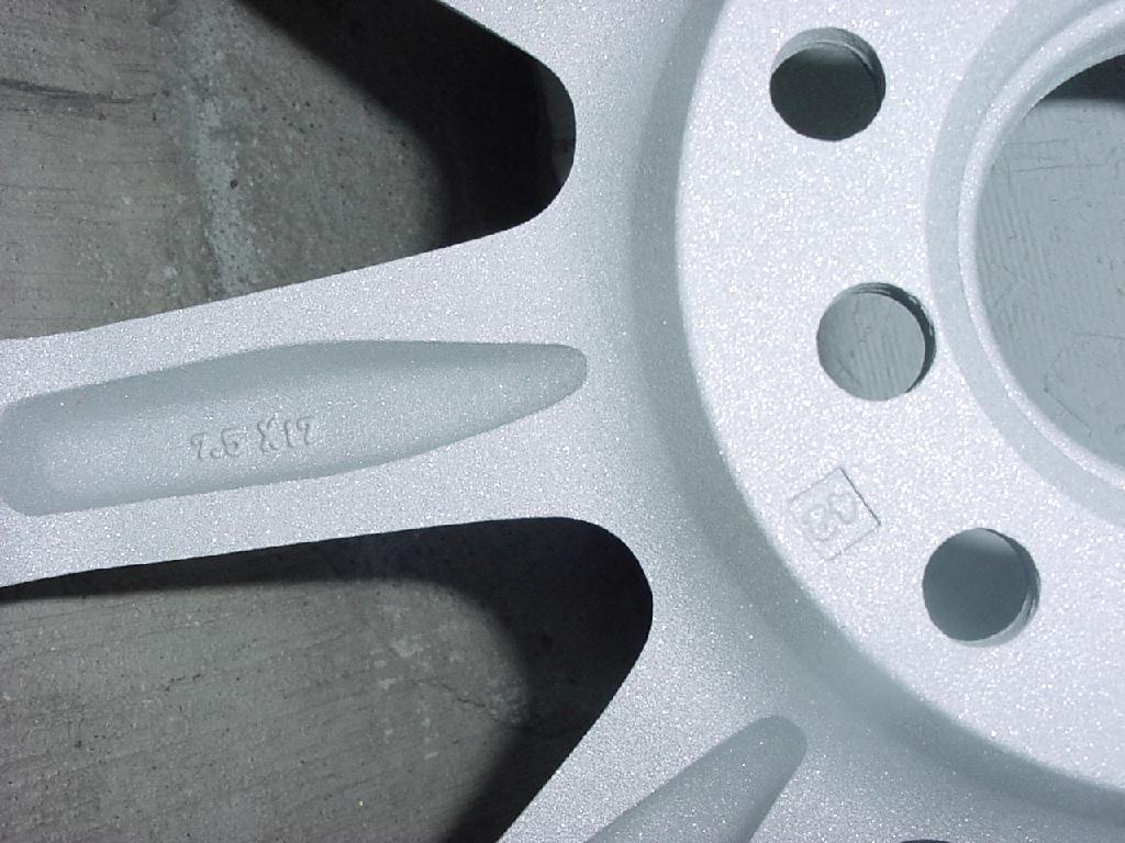

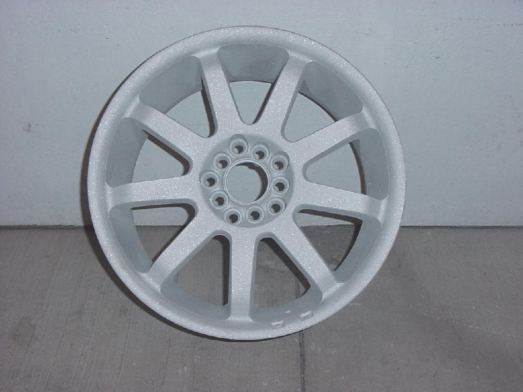

Powdercoating doesn't affect the strength of the wheel. Not one bit.
There are a couple concerns with powdercoating that could maybe lead someone to that conclusion, though. First, you have to be careful to remove any powdercoat that gets in the lug bolt seating areas and the hub mating surface. Second, powdercoat can mask cracks that form in wheels, which ultimately could lead to a failure. But honestly, how many of you check your wheels for cracks?
It's weird how incorrect information seems to permeate the internet. :rolleyes:
Powder coating will not weaken them, thats bunk. It heated up between 149 and 204°C and cure times range from 30 seconds to 5 minutes depending on how thick the application is. In the case of the rim, it was about 3 mins. This is not much different than sitting in the sun or all the heat that the brakes generate which is then translated into the rim through conduction. We could pick them up with our bare hands about 1 minute after they came out as in only 3 minutes just the surface of the rim was warm so the heat didn't stay very long.
When you powder coat wheels you blast them first, inspect them for cracks at that time, then coat after they are ok. Coating is around .10 to .19 mm thick, so it's not going to hide any cracks, nor will it add any significant weight.
2 piece wheels should be disassembled. Mark the center section in relation to the outter so it goes back exactly the same way plus mark all the screws so they all go back in the same hole. They are generally torqued about 30 or so ft/lbs depending on the rim. If you do this right, then you won't need to re-balance the wheels afterwards.
If you do it right, you can pull it appart, mark it all so it goes back together exactly the same way, powder coat it and it will last forever. Powder coating is 10,000 times more durable than paint could ever be. We use a PPG on our import traction bars which hang under race and street cars and take a whole heep of abuse, they are pounded by everything you can think of and NEVER chip. They only lose the coating when the bars acctually touch the ground on really lowered cars. We can smash the bars off a curb the metal dents and the coating doesn't chip or break. Paint will never do that ever.
Powder coating is absolutly the answer, if you can't afford it then the home paint job will do the trick. VHT and Duplicolor make some trick paints for exactly that application. I had a pair of wheels painted like shown above and they eventually chiped and looked pretty crappy. Thats why I had them powder coated afterwards and they lasted forever. Because of the paint chipping off they had to sand blast them to smooth them out from the paint chips all over the place. The wheels weighed exactly the same afterwards, so it didn't add any weight vs. paint.

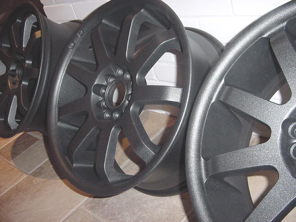

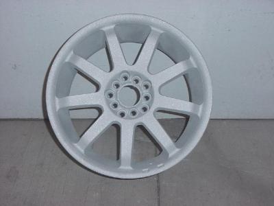

Here are my rims I did. They were blasted right to the bare metal then coated gun metal metalic. They were on my car for 2 years almost 25,000km and never had a chip or mark on them. I didn't have to remove the coating from the lug holes or anything, there is more than enough clearance for that. The lug nuts never even marked the powder coating never mind stripped it off. Also a pic of my buddies rim we did in Gloss Black powder coating. And a quick pic of the car they went on.... Didn't exactly go on a wimpy car either.. Thats a 150hp direct port setup incase you don't know what your looking at. The car ran almost 12's flat on that setup on pump gas (with slicks). Those rims saw a lot of street use and abuse it would spin the tires on the highway so I'm sure the rear wheels took some rocks flying off the front.

No, you can't do that yourself, it was my buddies business, I just went there and he showed me how to do it and I snapped some pics on the way.
It was about $50 a wheel here Canadian. So I'm sure you could find somebody local to do all 4 for around 150 or so ish US$...
at $150 for the set, that's not bad at all.
