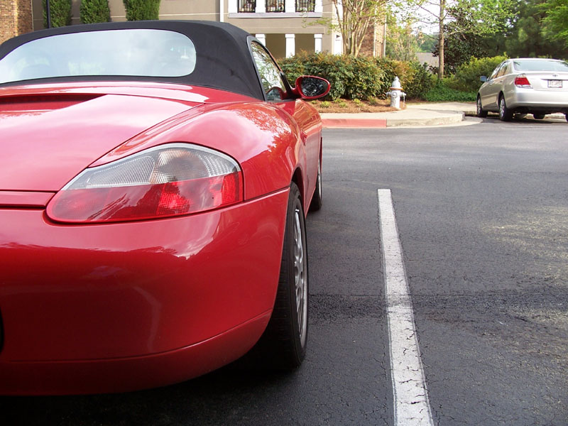

Do you have a photo of the 265 & 275 on a 10" wheel? How much (if at all) does the rim protrude for each tire size? Thanks!
this pic shows the 275's. the really don't stick out at all; they're flush with the fenders.

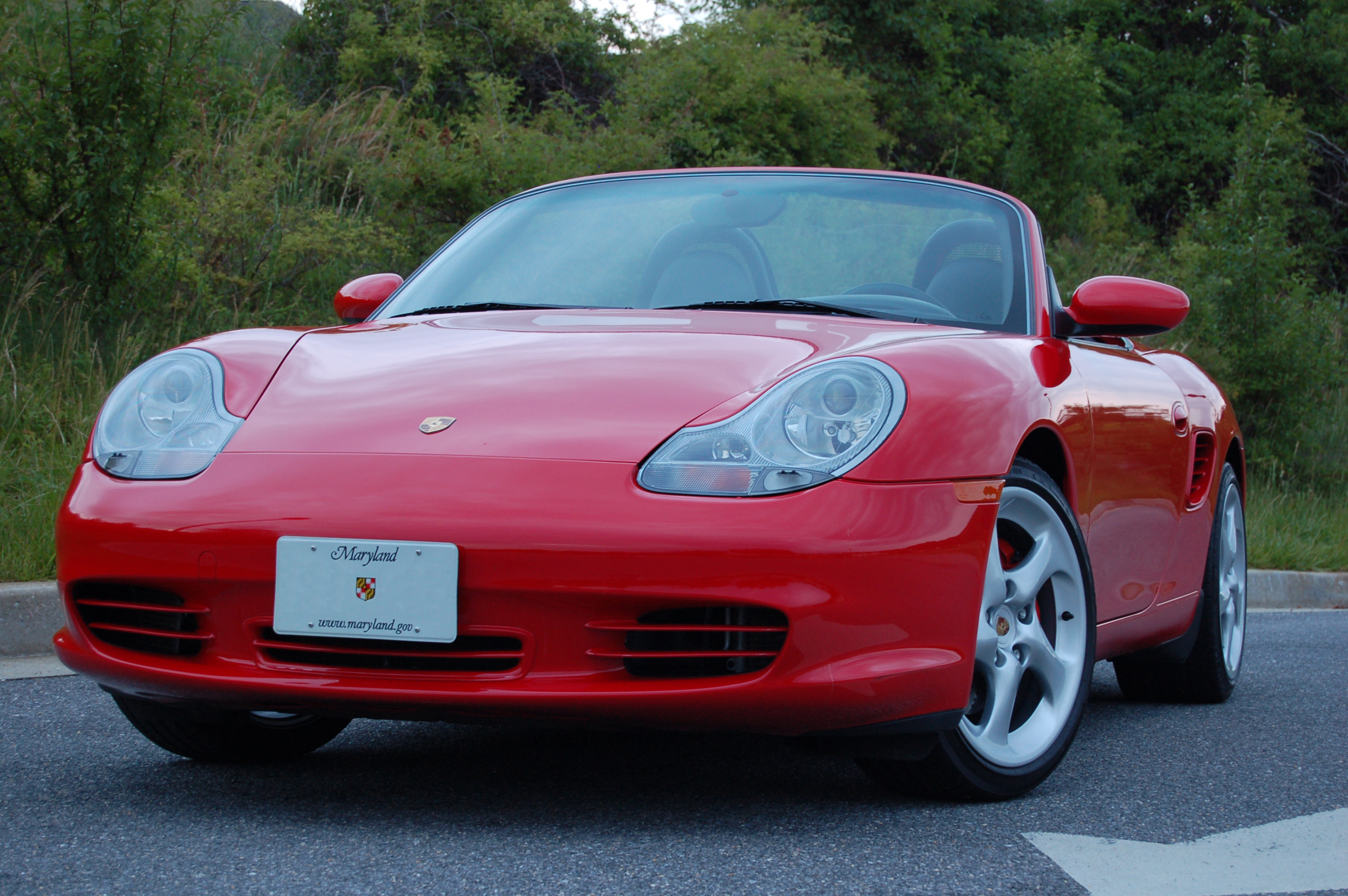

Do you have any pics?
thanks!
here's a few. oddly, i don't think i've ever taken a picture of both cars before, so here's the entire stable (all two of 'em):
