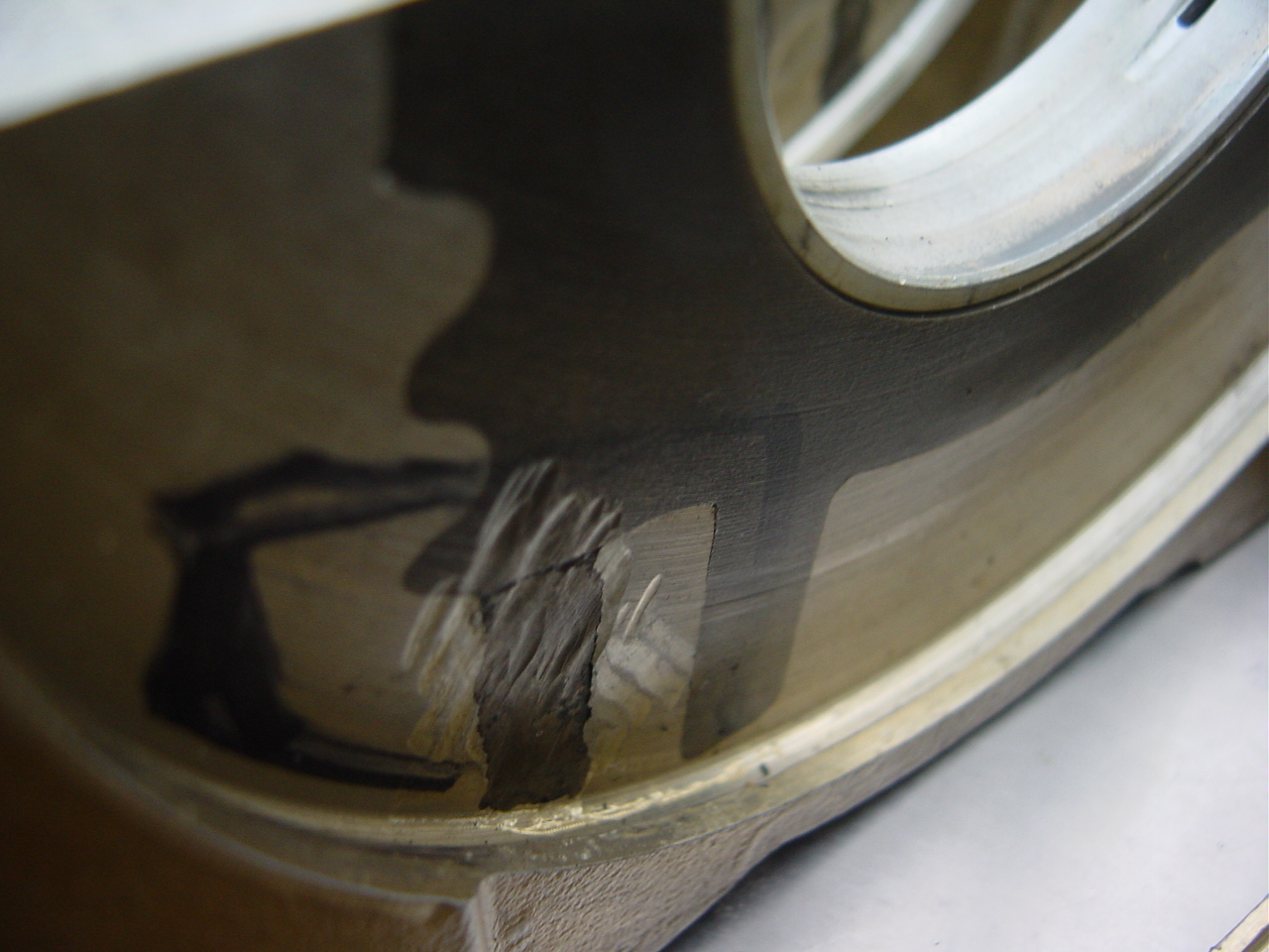

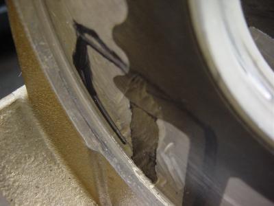

My view is the same as one already posted earlier - the shape and configuration of the darker sections is a metallurgical function of the way the block was originally cast, either to dissipate heat from the molten metal pouring process or as a function of strength during molten metal cooling ( and possibly in use in the car).

Very interesting problem....It is difficult to tell from the photos if there is material missing making the indent or if it was peened in. Also are the marks on the bottom or top of the case ( can't tell which way is up ). Its hard to imagine something making those marks due to a passing rotating element. You might expect to see marks travelling in the direction of the rotation. In picture 6691, on the lower bearing, there looks to be some kind of grinder marks like a burr was removed. Like the others, I will be very interested to hear of the cause of the marks. Maybe they are just cosmetic.
There appears to be no ill effect on the crank or bearings so I can't see how this issue would be related to misfiring.
PS the car IS beautiful.

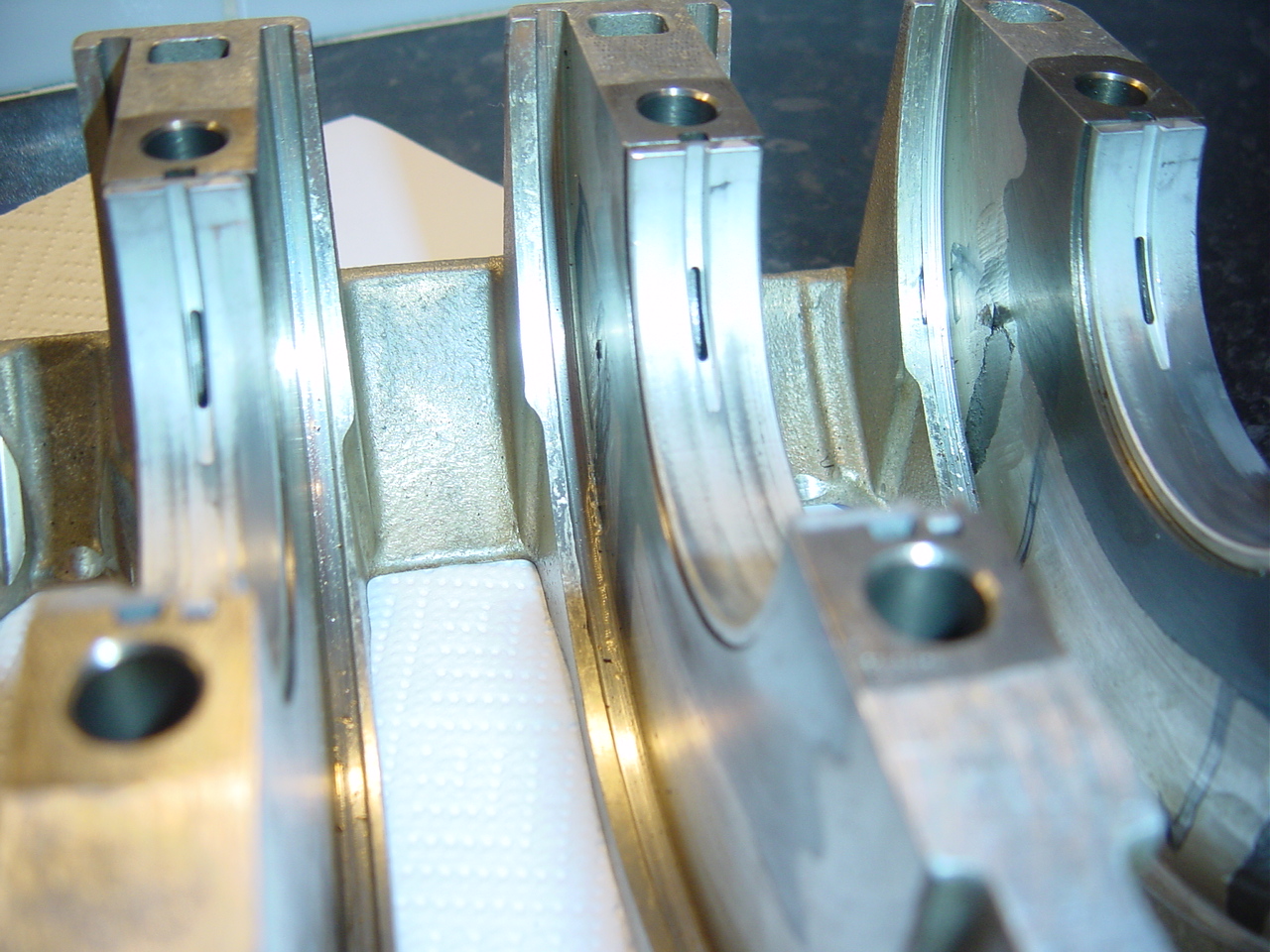

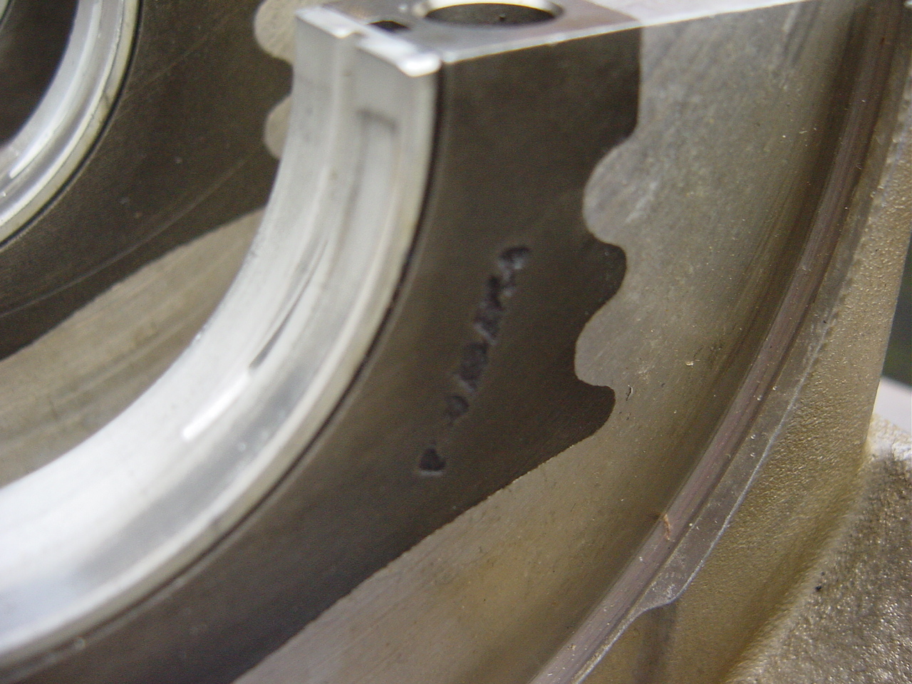

When I saw the engine last week I noted there were some other gouges/grind marks on another part of the engine. I went back again today and took some more photos for comment. The photos are the same part and photographed at both the left and right ends i.e. there is gouging/grinding at both ends. We're not sure whether these are manufacturing marks or anything problem-related. I did notice that on one photo there is evidence of the metal cracking/flaking.
In relation to your question, I can't say which of the two crank block halves are upper and lower (or right and left) but I'm wondering if the one half that shows the gouges & cracks fits into the other part shown in the latest photos and that there is a relationship between these marks.
There are no broken spring valves or anything else that the specialist has seen as broken when dismantling the engine so we can't relate anything back to the metal that was found in the sump yet.

You often find swarf caught in the filter/sumps of a higher mileage engine, doesn't always mean that things are going south. The photo's look like grinding marks to me, I've seen these before in other engines and are done to remove casting seams. I don't see how this would cause a mis-fire.

Thanks for your response. The grinding/fettling of casting seams was favoured by the specialist as well. However my thoughts are that they are too random to be factory-based marks as I would have expected anything done at the factory to be far neater.
The OPC that I purchased the car from commented that they had experienced swarf being trapped in tappets causing a misfire to move between different cylinder banks, but that was on a new car. They'd not seen swarf in a car with the high mileage that mine has done.

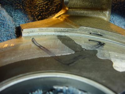

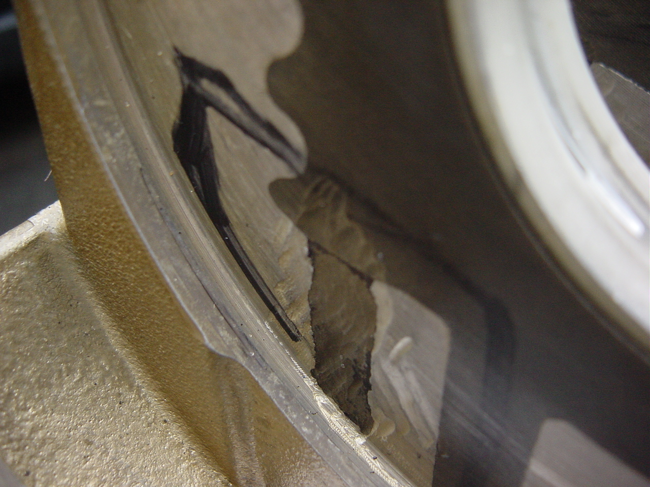

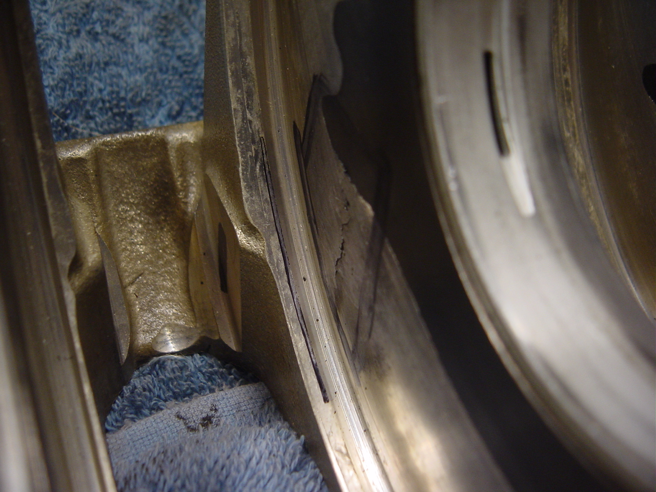

I made another very useful contact yesterday and took the faulty crank cradle to show him. He noticed that the metal was flaking off one part and I've attached two photos to show this. I'm now more convinced that the metal that was found in the sump was off this particular part. Whether it was the cause of the misfire we'll never know but I doubt it was. He also said that the grind marks in my earlier posts would definitely have been done at the factory. It looks like they were trying to grind off some material from the casting process.

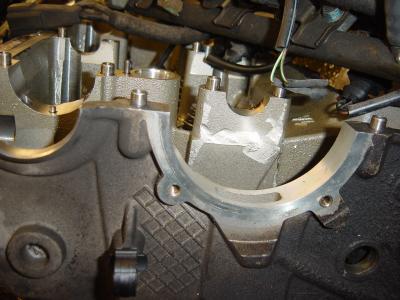

Also you will see from the other attached photo that another part of the cradle is showing fractures in the surface metal which I'm sure in time would have gotten more severe and flaked off as well.
My thoughts are now that it's probably a good thing that the engine was dismantled to discover this. If it the msifire had been identified and cured without engine dismantling, more metal could have broken off and caused a major engine failure whilst I was on the motorway or other fast road.

I sent a lengthy letter and 13 other supporting photos showing the grind marks in close-up and more detail and a further imperfection in the bearing support metal to Customer Assistance (now there's an oxymoron if ever I heard one!!!) in Reading today. I quoted the Sale of Goods Act 1979 and stated that the marks on the crank cradle could only have been done at the point of manufacture or assembly and certainly before the car's normal lifetime began. I also pointed out that only areas that had cracks in showed signs of grinding. Hence the part in question was and still is, not "fit for purpose".
The photos I included clearly show ancilliary marks left by a grinding tool on the curved parts of the crank cradle section involved. (Example attached).
Their attitiude was that's just your opinion, prove it and we're not changing our decision. They invited me to get an independent inspection done if I wanted to pursue the matter but there would be no guarantee that they would change their decision.
