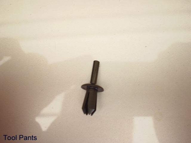

I am trying to remove the map tray under the steering column. It seems to be help in place with what I imagine would be screws but they are flat, almost like plugs but I can't get them out. Any suggestions?

There are 2 plastic "rivets" that have a pin in the middle. This pin expands the the rivet. Hard to see that there is a pin in the middle. You need to push the pin out.
Do you know the Porsche p/n for these plastic fasteners.
