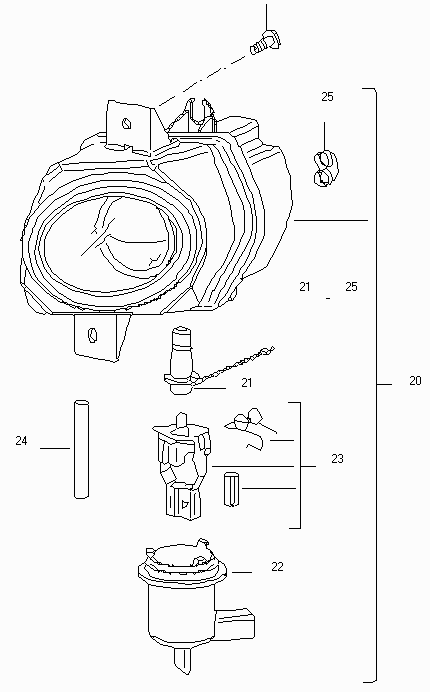

I was wondering if any of you folks on here know how to replace the foglight bulbs on the 997TT? The owner's manual doesn't say anything about the foglights.

Looks like they come out the bottom to me.
The parts list says they are H3 bulbs.
(item 21 is the bulb and 22 is the socket and 23 are "repair kit bulb holder")

Thank you as always, Loren. Looks like I'll have to find a lift or ramps to do it from.

I lifted the car up and had a look underneath. It's really tight in there but with small hands, I'm sure it's possible to swap out the bulbs.
