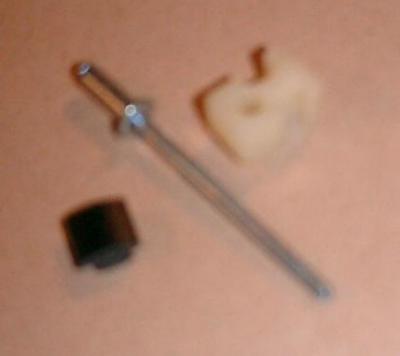

the new regulator assembly came with a small bag with two part and a rivet nail (see photo). i'm hoping these are for a 996 install as i see no part on the existing regulator that corresponds nor any reference in Bentley or other writeups (such as bombaydigital).

I did this repair a short while ago. On the rail that is closer to the front of your door, you will see that there is already one of those white plastic things riveted in. I'm not sure if that existing one is for a 996, but for your Boxster, you will need to rivet the plastic item from your bag right above it. There is a little slot and setting for you to place it and you will need a pop rivet gun to apply it. If you don't apply the extra plastic piece and rubber grommet, your window will rattle when you close your door.
thanks. interesting but there is nothing similar on my early model 97. there is a blue plastic hump on the lower front rail but it doesn't match what is in the bag.

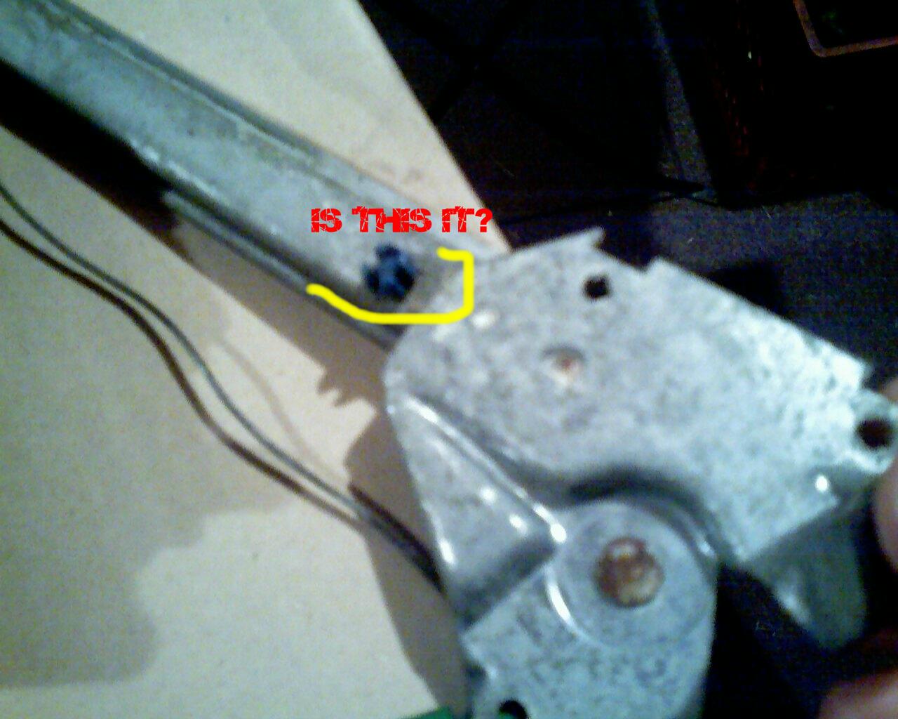

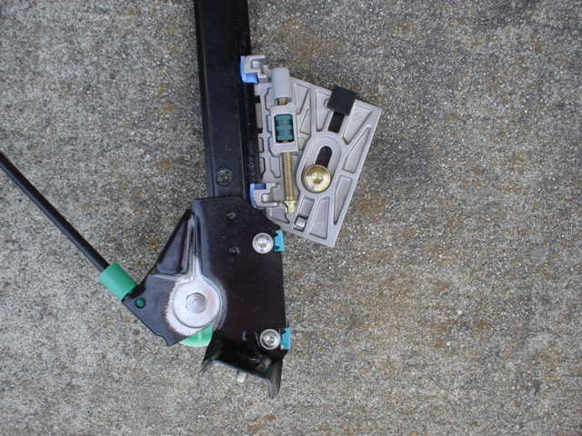

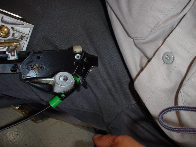

EDIT: I just added two photos of what may be the need on mine...as I don't see such a piece of plastic on the new regulator. The design is 100% differnt then what is in the bag, so I don't have a clue how it attaches!
See images...
Edited by rsfeller
ok i may have found a fit for this gimzo that doesn't match anything on my current door. it looks like it could go on the window clamp but once again with no photo, TSB or exisiting reference it could go on two differnt ways...

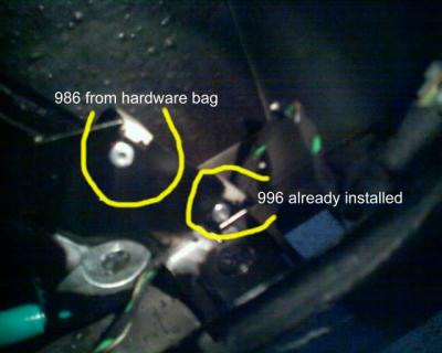

We'll here is what I finally figured out. There was one reference to +rivet & +window on the 996 board and I found a photo to the so called rivet/stop here: http://www.renntech.org/forums/index.php?s...l=rivet++window
With help from that post I determined that a 996 window "bump stop" is already installed on the front regular at the bottom to prevent window travel being stopped by bottom of door. Therefor that parts in the bag are for a Boxster. The 996 window travel is farther for some reason. (maybe someone knows why). I really didn't see the need until after the regulator was installed.
Looking at my photo at the bottom. I was still able to (barely) rivet in the hardware with the regulator installed. This is looking into the drivers door at the front regulator at the very bottom. The "bump stop" is on the back side rubber side up.
If you have an early model 1997 986 like me I would not re-install the blue stopper in the rail. I was going to do this and determined that the cable does rub on it and can get caught under it while installing it, if done incorrectly. This solution was obviously an upgrade to accomodate an inexpensive solution for both the 996 and 986.

Sorry for the late reply - haven't had much time lately to check the board. You pretty much got it right with this picture. When I did this install, I didn't rivet in that extra stopper. As a result, whenever I closed my door, the window would make an extremely annoying rattle. It really does serve a purpose - I learned that the hard way by doing it twice!
Replacement regulators use to come with 2 stops installed that were blue plastic and were held in place with a torx screw. You left in the upper stop for a Boxster.
The new replacement regulators I have seen come with the lower stop riveted in place. The upper stop and rivet is in a plastic bag. Those stops are white plastic.
