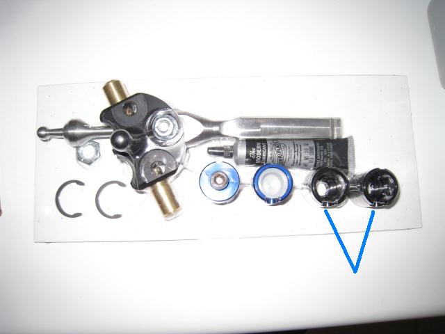

I paid $200 for this....
Did I get the real one?
It came in the box with instructions... Bought it online from what I believe to be a reputable store.
Looks like the real deal to me.
Looks like how a B&M is packaged.
But it also looks like you have 2 extra bushings, which look black.
The housing for the shift lever looks black, not blue.
I see the tube of lubriplate grease that comes with a B&M.
Could be your crappy pictures and the flash.
Hi ToolPants you are right the housing is black, which triggered my doubt. Wasn't aware of the two additional brushings.
I got the part from bumperplugs.com. Any experience with them?
How do I make sure I have the real thing. Should I call B&M?
Gus
Eric (bumperplugs.com) is a Contributing Member here - so you can always PM him.
I think what he sells is the real deal.

I called bumperplugs and they were very friendly - accordingly to the person answering the phone (who now I know was Eric himself), they sell the real B&M and the company started using black last November. B&M tends to do some cosmetic changes overtime.
