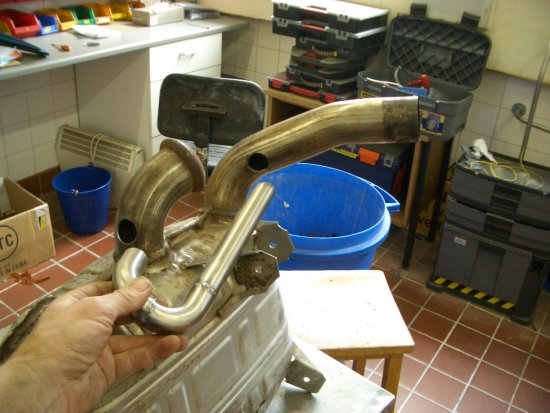

Two or three guys on the PCGB forum have bought them and are very pleased with the result. The original PSE had a silencer bypass pipe with a valve to open or close the bypass. The Oettle system is doing the same job without the valve. I have just bought a pair of standard mufflers on eBay, and am about to do this myself. It will probably take me a couple of weeks to get around to it, but here are a couple of photos of what I plan to do.
Porsche PSE:
Planned Mods:

thanks for a prompt reply. Is that all there is to it? I.e. couple of holes and the a piece of tubing welded in place?
If You could post some pictures of the process that would be appreciated. I plan on doing this as well...if it is that simple.
The link You attached is the one I meant - same company.
Porsche PSE:
Planned Mods:

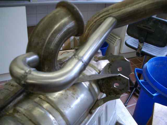

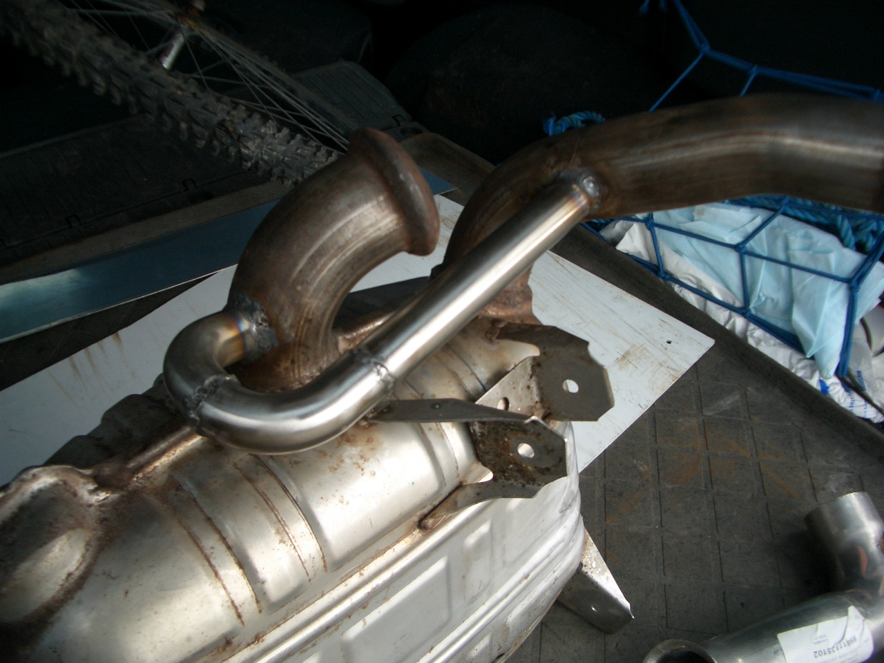

Richard hamilton. My photo,s of mods. Seems like everyone fancy,s doing this mod. Heres a few more pics. The cost is about £30.00 English & a mate with a tig welder. The sound is very good as richard will tell you we both did this mod, The thing with the PSE system is you never turn it off so why pay the bucks. Other thing is you never bother to turn the radio on anymore the sound of the exhaust is all you want to hear. A pic of the finished article with the cut down turbo bumper & turbo tails
Richard and Steve: do either one of you recall what diameter tube used for this modification? Any chance either one of you have sound clips? Just to confirm, both of you have the 3.4 mufflers, correct?
I used 1 inch o/dia stainless steel tube and bends. Yes - mine is a 3.4.
Thanks to Steve for his help with providing the pictures, and pointing me in the right direction.

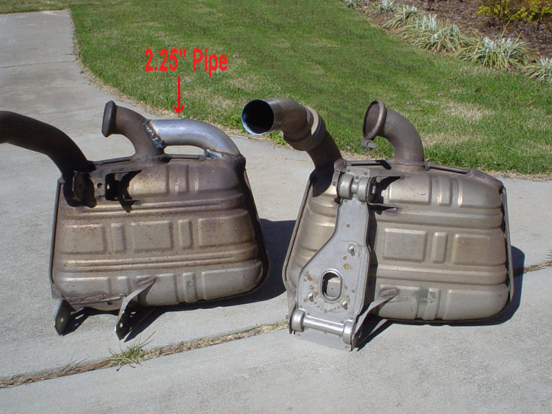

Am I correct in assuming that the picture on the left is the type I mod while the picture on the right is the type II mod?
If your referring to FisterD's response. The left side is the MK2 and the right side MK1 type mod.
I don't follow the MKI, MKII designations...sorry or the confusion. I classify my muffler mods by "stages". The less aggressive, less loud being "I", and the louder , more aggressive being "II"
My Stage I (MkII) is the milder, less aggressive mod. Connecting the third unused port to the outlet.
My Stage II (MkI) is louder and more aggressive sounding. connecting the inlet directly to the outlet.
