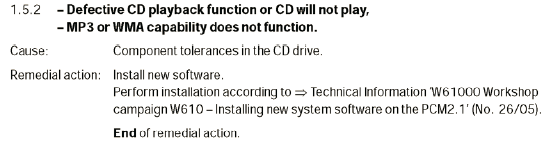

Have your OPC refer to TSB 1/05 9110 PCM2.1 System Connection: Complaints and Repair -- dated May 5, 2006.
Excerpt...

I think you will need to refer to the TSB's on this forum regarding MP3 player compatability. Only the PCM units supplied for MY2006 came with the ability to play MP3 tracks using the front CD drive on the PCM. The earlier versions of PCM can only be upgraded to version 3 software. The later versions of PCM (MY2006) are running version 3.3 currently I beleive.
Excerpt...

There is an update CD available that takes your software on the PCM from Model level B version 3 to 3.3, the part number is 000.043.205.46.005. The tech bulletin suggests it refers to the post that Loren has inserted in this thread , and also allows for a check / repair of the CD drive. Though i have a copy of the software CD , I haven't been brave enough to update it , as my PCM 2.1 is outside of the model numbers listed on the associated tech bulletin. I have already updated from Level A version 1 to Level B version 3 to allow use of a 2006 map DVD. Even with this update to level 3.3 i'm not sure that the MP3 player facility will be available , as it's possible this is hardware specific rather than software. Since the update of the level A to level B software can be done using the CD drive on the PCM , it's possible this update can also be done in the same way. If there is anyone brave enough to try updating an early version PCM to level 3.3 please post your experiences and results here.
