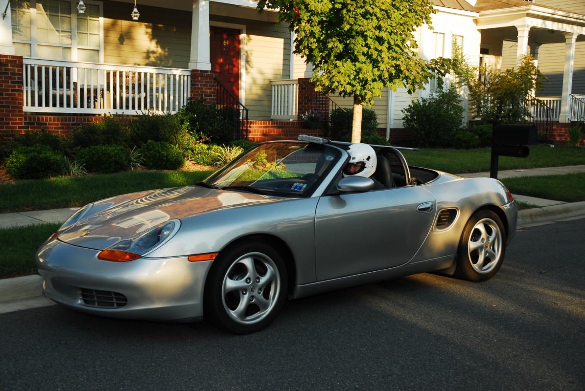

I am only 6' but I have to open the the sunroof on my coupe when I wear a helmet.

Guess I'll chime in too. I'm 6'2" with a 34" inseam and I'm a really tight fit in my 2003S. I put 2003 factory 996 GT3 seats in my Boxster late last year because the stock Boxster heated seats are like sitting on a brick. The GT3 seats are significantly more comforatable and are heated too. The bolsters are higher and the seatback seems more supportative and the two give the illusion of more room. I also put the GT3 console delete center kit in too and that was the biggest improvement. That center stack interferes a lot with taller driver's kneeroom and getting it out of the way really helps.
I worry about the rollbar/ seat height relationship, but mitigate it a bit by raising the seat just slightly. I've also found that driving without shoes seems almost the same as adding legroom. Anyone 6" or over tall has big feet and the Boxster footwell is small. Those cute little driving shoes aren't much better than bare feet in times of stress, so the extra room gained by taking off your shoes isn't much of a compromise on the street.

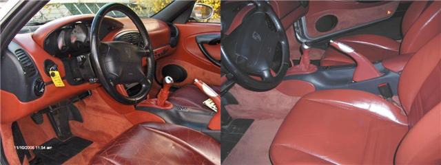

Just to update, I have temporarily taped on some Home Depot pipe insulation. Based on testing it with my head [without risking an extremely embarrassing head injury], it will certainly help a lot in the event of a rear-end collision, by augmenting the stiff padding in the rollbar.
John S, the plasti-dip is a good idea; but I'm going to cover the pipe insulation with leather, then lash it to the rollbar with a couple clear plastic cable ties. I have a quart of latex paint photographically matched to my interior color [boxster red; also from home depot], so I might paint the leather to match. And it sounds like you are experiencing the buyer's remorse I initially had. If you're like me, once you get used to it, and see how many smiles this car can bring, you'll feel better.

Nurvus: I like the idea about using the leather, except I think if you paint it, the paint will just flake off. Suggest you either dye it or just get pre-finished red leather from a place like http://www.sbearstradingpost.com/Leather.h...whideUpholstery. Please post photos once you get this project done. For me, I decided to wait until Spring, when Wal-Mart starts selling the foam tubes that kids play with in the pool. Those have thicker and stiffer foam than the pipe insulation we've been talking about and hopefully more protection. I suspect the Plasti-Dip finish will prove easier than trying to fix leather, but we'll compare notes later.

Latex paint actually sticks well to leather. And I have some primer tinted to Boxster Red as well, which makes it adhere even better. My seats had been previously painted and were bad again, so I primered and re-coated them. I've done this on black leather car seats before with great results. I use the paint for other interior parts as well. Getting lots of compliments. If it holds up, I save $1000 for replacement skins/seats. If not, I'm out $10. I attach some before/after photos.
I think I'll just paint the insulation itself, then lash it to the rollbar with wire ties. But can't do the work in this weather!
