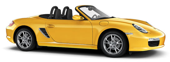

For grins, I copied the picture from the Porsche 'configurator', to show what I saw, the clear markers compliment the clear headlights nicely!

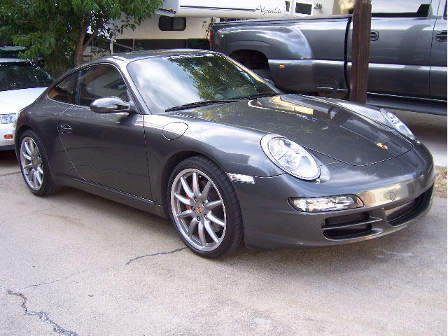

Hi,
I just installed the clear ones on my 997 S.
Order them from Suncoast and had them in a week.
Installing them took about five minutes.
Paul
(edit - made image viewable - Loren)
