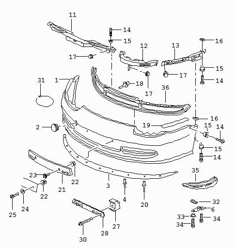

For MY01 and older use: Item 4 -- 999.507.427.40 expansion rivet (11 needed)
For MY02 and newer use: Item 20 -- 999.507.497.40 expansion rivet (21 needed) and PTL4037 - PUR - GF15 - SW adhesive tape.
Thanks Loren!
I got the expansion rivet part, but what is "PTL4037 - PUR - GF15 - SW adhesive tape", a bit confused here...
humm...... the lip I got doesn't come with anything except the lip itself. I will find more detail from the shop.
