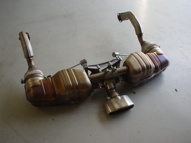

When I have looked at a Cayman/987 mufflers I see an integrated unit that is also the catalytic convertor. The cat and muffler are a single part. The parts list has just a single part number. Here is a picture of a 987 exhaust.
So, I do not know how you can do what you want without cutting something. But you could do this on a 986.

Thanks a lot toolpants, I think I'll have to take it to a shop to have it taken a look at. I will post any info as soon as I get time to do that.
