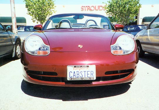

This is Peter Smith's 1999. His car was also hit in the front. In fact, the body shop that put the 996 cover on was the same body shop I used.
Yep, it is completely plug-and-play. You might want to get a few spare plastic clips, in case one or two break. I think there are fewer than 10 of them, holding the wheel well liners in place. As Jeff says, you will want the non-tiptronic version of the 996 bumper so that there is no open hole in the center (it should be black plastic where the hole would otherwise be). That's what I got, although I later cut out the center bezel section when I installed the center radiator.
Before cutting center out:
link
After cutting center out and installing center radiator:
link
