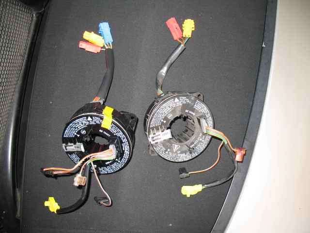

I want to disable the 2 buttons on the steering wheel and add my own button somewhere close to the gear selector. Anyone know where/which wire loom to disconnect and tap into the circuit?
1999 996 C2 Tiptronic
The shift buttons run to the 2 wire blue connector on the tiptronic unit on the left of the picture. The unit on the right is for a manual transmission, so ignore it.
