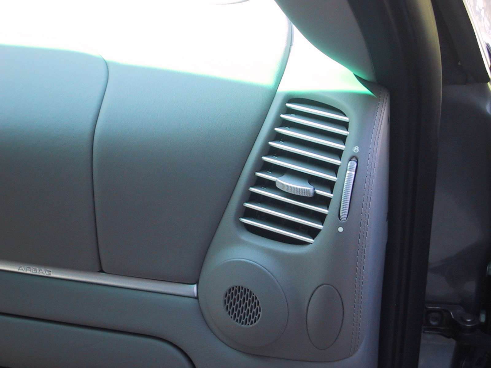

I am replacing the black side vents with the aluminum/leather ones and was hoping someone (Loren?) could tell me how to replace both sides including removing the oval/round/light controls from the older vents and putting them on the new ones. thanks in advance, alex
:jump:
Thanks Loren got the driver's side out, how about the passenger side? :renntech:
Remove cap (20) and then the screw (21) from inside. The remove the two screws (21) from the door side of the vent. Disconnect any electrical connectors (if there are any).

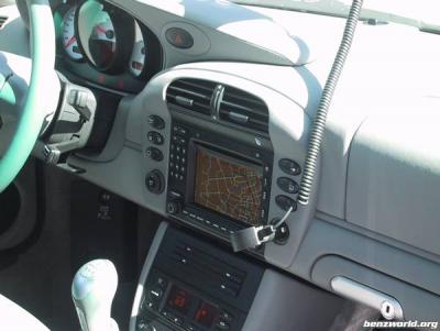

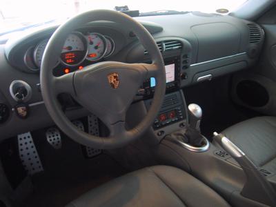

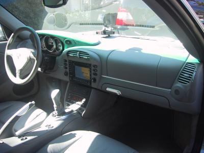

Will post some before and after pictures, but here are the main items that I have changed. It looks much better now, though not cheap:
Leather Visors-lighted
Aluminum look 3 strips
Aluminum Instrument Bezels
Aluminum/leather side and center vents
Leather Instrument Surround
Heated Seats wing in leather
Turbo Embossed leather stiched ArmRest Center Console
Seat Coat Hangers in Aluminum look
Leather covered Cup Holder
ALuminum Look Ignition ring
RUF Aluminum Pedals (all for 6 speed)
