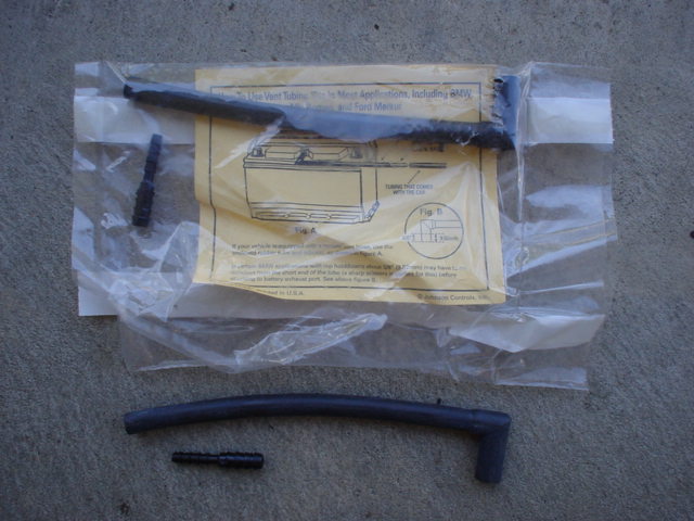

The Interstate batteries I have seen in Boxsters came with a vent tube adapter that looks like this, so you can connect to the clear plastic tubing in the car. If you do not have this part and you have a vent tube in the middle rear of the battery then go back where you got the battery and get one.
Sorry I have not been clear. But you have answered my question. You are correct I have the Interstate battery with the vent tube in the middle rear of the battery and do not have an adapter. I will see about getting the vent tube adapter. Thanks. :thumbup:
That was easy. The black rubber tube and black plastic adapter should have been in a plastic bag stuck to the battery, but sometimes the bag gets lost.

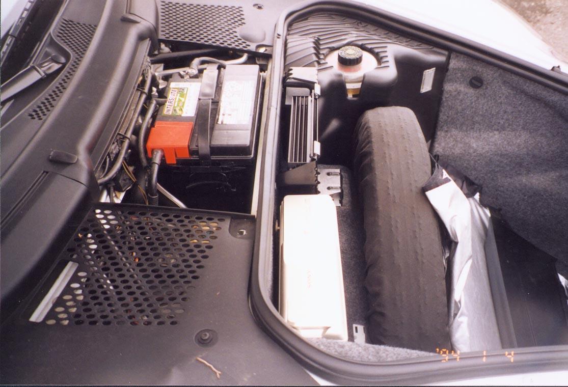

This is an Interstate. You can see the black tube to the left of the red plastic terminal cap. You can't really see the black plastic adapter because the cable is in the way, but it you follow the black tube you can see it is connected to the clear plastic tube in the car.
