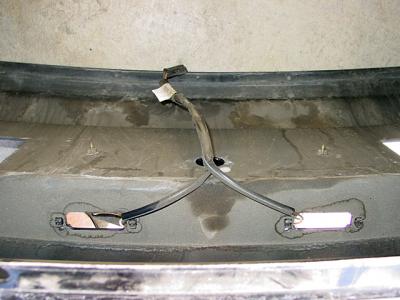

Hey guys, I just replaced the 2 license plate light lenses and bulbs. I had noticed while under the car last week that both were cracked where the screws go in, a result of someone overtightening them. Both bulbs were burned out also. So today, when I popped the new ones in, which I was thinking was maybe the easiest thing I have ever done, they don't work! Grrr. What is going on here? Thanks.
Holy smokes! The connector is unplugged, and fell down between the bumper cover and the heat shield, behind the license plate area. I think I might be taking off the bumper cover, what do you think? I don't have tools or hands small enough to get in there, retrieve it, and plug it back in.
* 1 hour later, all fixed. Thanks Loren. Here are a couple photos for reference in case someone else has this problem.
