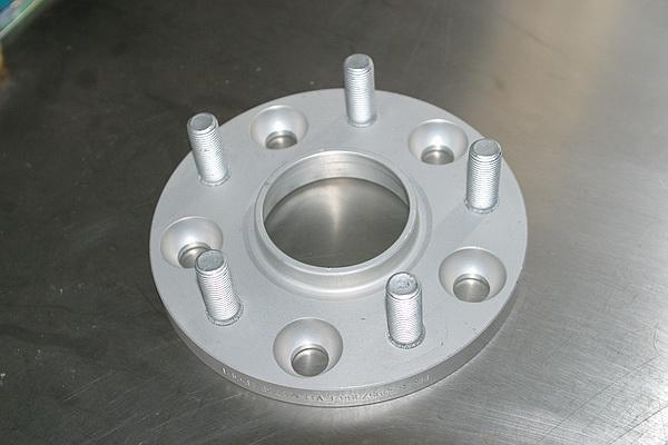

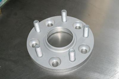

My friend Henry has 7mm spacers on all 4 wheels with the original wheel bolts. But if you do that and your wheel with a 5mm spacer comes off do not go looking for me. Pic from Paul.
It is a kit so it should. For 2 wheels. $287.50 suggested retail as of November. With something that wide you have this type and lug nuts like a normal car. One of our guys has it on his rears but I'm too lazy to find the film picture I took last year and scan it. Pic again from Paul.
