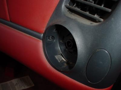

I did not take the sensor out, just the grill. It was a long time ago and I think I did it to show the hidden screw behind the grill for when you want to remove the side vent.

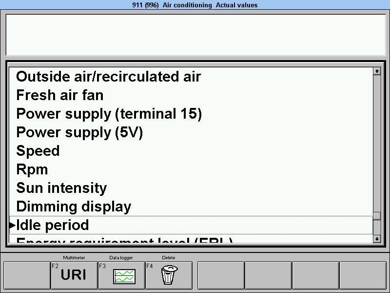

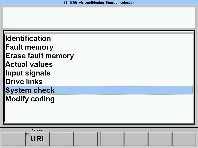

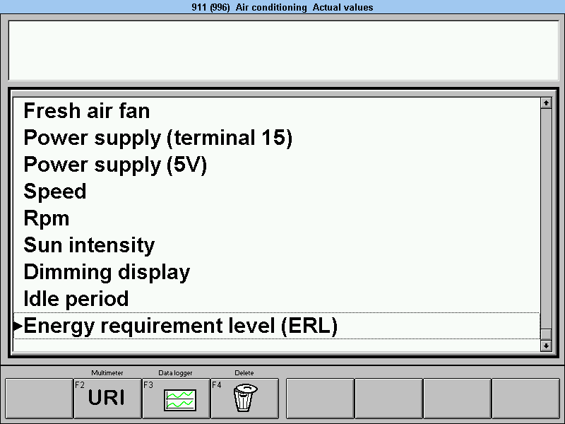

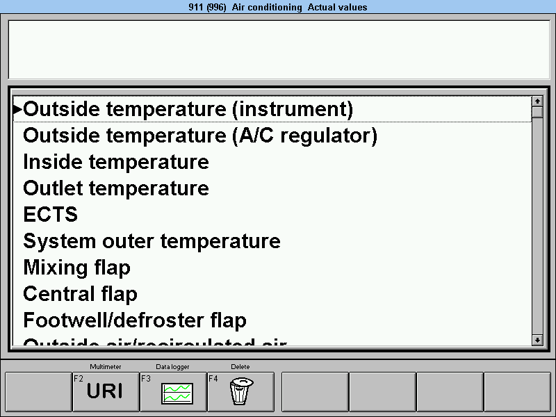

There are many other tests you can do with a Porsche PST2 or PIWIS tester.
For example: actual values readouts to test flap operation sensors, switches, etc., etc.
Try to find an independent shop that has one of these testers - it will make short work of diagnosing your problem.

Yes. it could be a bad heater control valve but I think it could also be a bad sensor (thinking it is already hot enough). With these testers you can actually test each (independent) part of the system for proper function.
