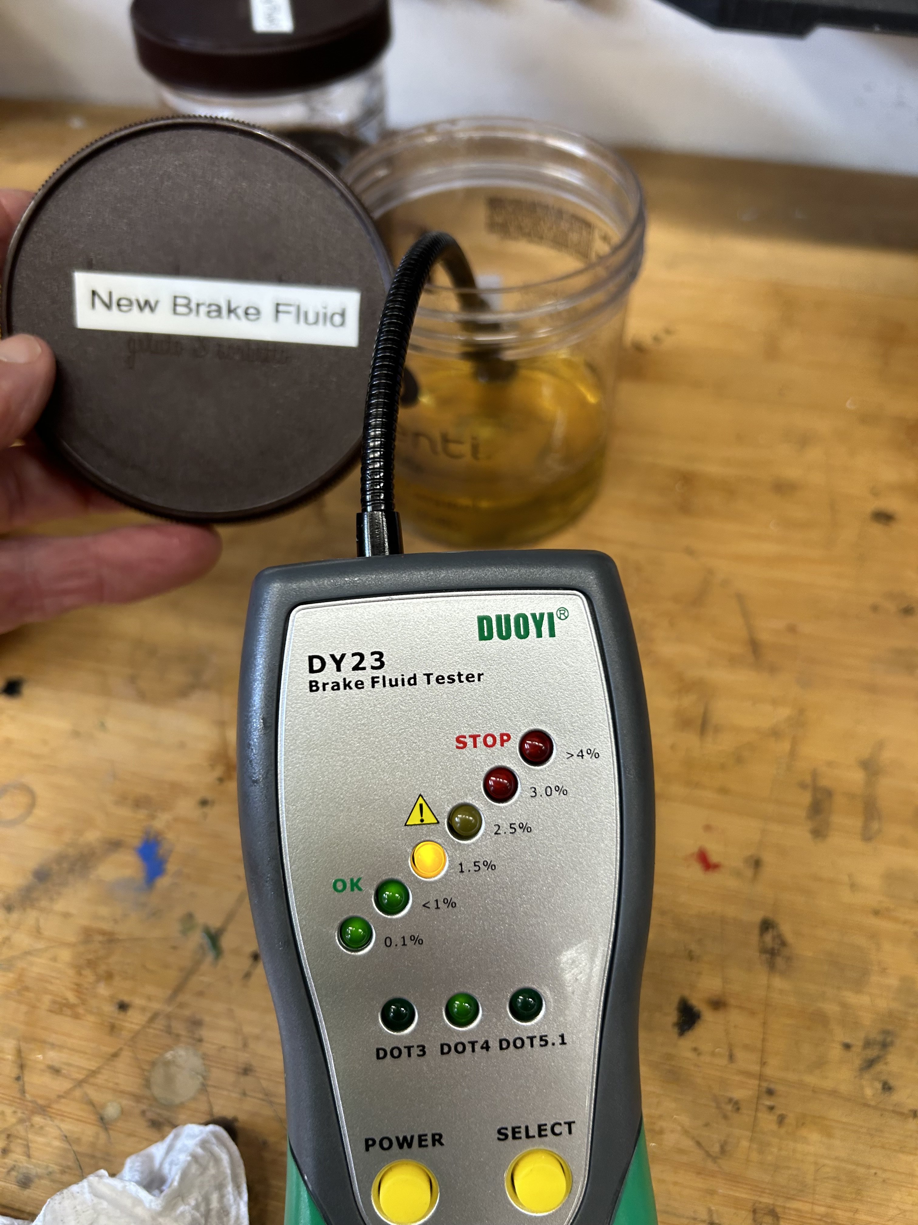

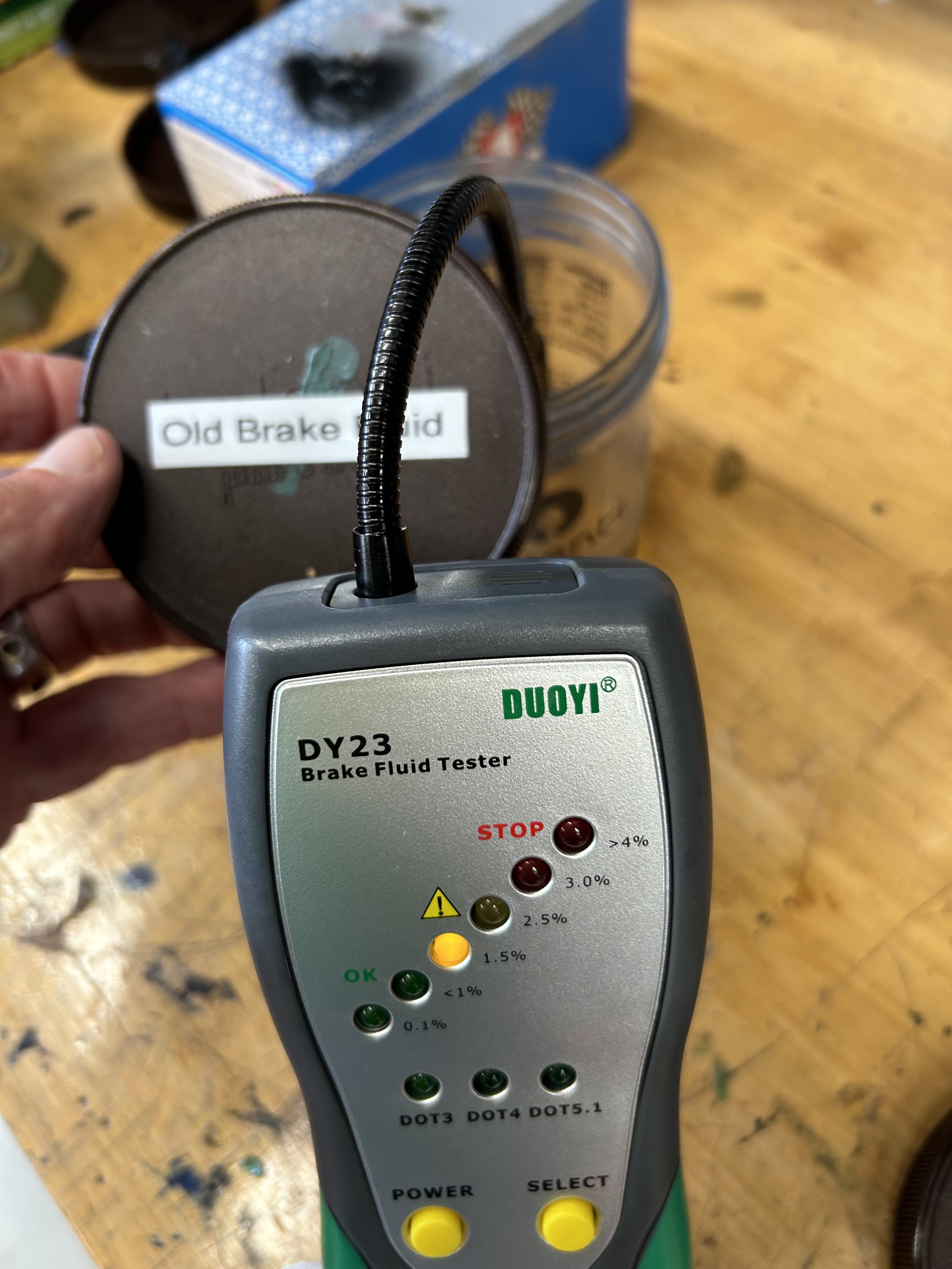

I used a two prong tester similiar to the one pictured. I fist tested fluid from an unopened container then tested my 2-3 year old fluid from the Boxster. Results were nearly identical. See IMG_0182.thumb.jpeg.80444edc8e40c84f1d4903ff9f4d9727.jpegIMG_0181.thumb.jpeg.97cc27421a0c210aafa69b6c1d08dad9.jpeg

I have no experience with the electronic brake fluid tester in your picture, only the OTC pen tester, so I cannot opine except the following.  The fact that it's saying 1.5% moisture content for brand new fluid -- it either isn't very accurate (most likely) or the new fluid you bought is contaminated with moisture.  I see they have different colors in your measuring strips but I don't know what % that translates to.  New fluid should not have high moisture content, this is the whole point of replacing the fluid to get the moisture content down.
Silver_TT has a valid point, a fresh container of Dot 4 fluid should read zero moisture, not 1.5%.  We tried the test strips once, found them to be very misleading and very often inaccurate.  One of the main advantages of the digital tester, besides dead on accuracy, is that you can test the fluid while it is still in your car.  While that sounds more convenient than useful, using the digital tester on customer cars, we have found that for some owners, we don't need to change the fluid as often, sometimes 4-5 years between flushes, and without any concern.  That alone can be a substantial cost savings to the owner.  And we also test every container of Dot 4 fluid when we open them, if any are above zero, they get sent back and replaced with fresh containers that test properly.
So if you haven't done so, do not use your new fluid, that moisture level is already nearly out of spec; and if you have used it, get some fresh Dot 4, test it, and then reflush the vehicle.

When you buy brake fluid, you typically have no idea how old it is, or how it has been stored.  A properly sealed container should be a zero for fairly extended period, but because Dot 4 is so hydroscopic, and some containers, particularly plastic ones, are moisture permeable and can suck up moisture sitting on the shelf.  That is exactly why we test them.
