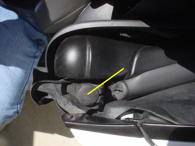

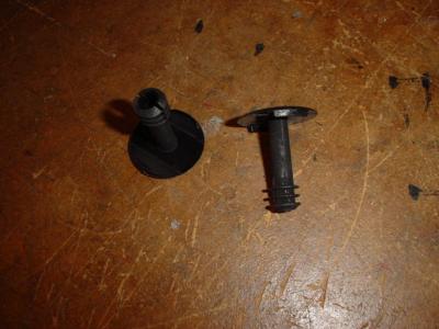

There is no umbrella valve/plunger for the top drain holes. This is misinformation on the Dieter site.
The plastic plug they show is a plug for the spin lock insert. They like to fly around and end up under the top near the drain hole.
Just clear the 2 drain hole of debris and run a garden hose in there to make sure they are clear.

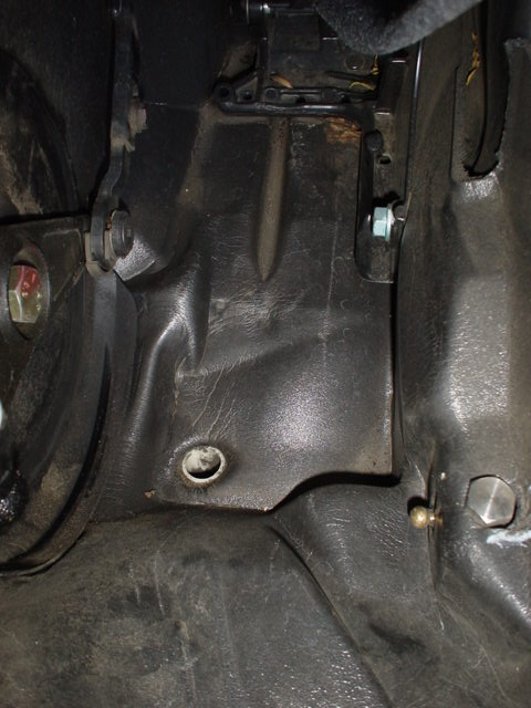

If I remember correctly, the drain tube runs to the wheel well. If you look in the wheel well you will see a black plastic plate with 2 plastic nuts. When you test a drain with a hose do you see water comming out in that area? You might want to remove that plate when you do the test.
