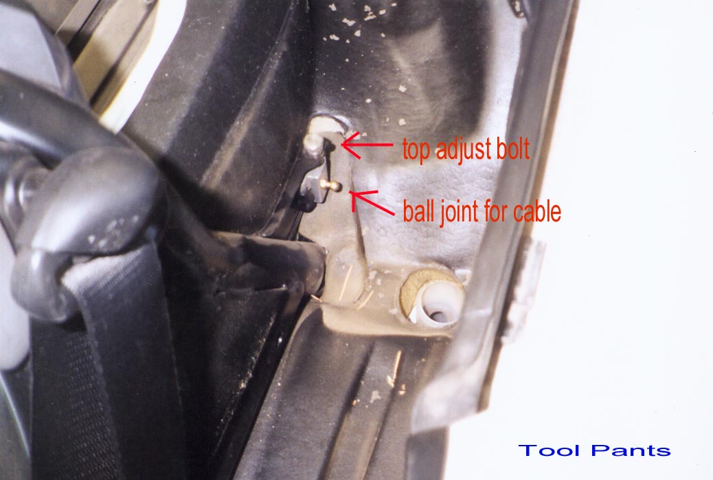

I am referring to the pair of cables that hold down the back part of the soft top while in the up position. These have sockets on each end that pop onto ball joints.
There is an article saying that if these cables aren't tensioned properly, a "loose change" sound can be heard from behind the drivers shoulder.
Is the "loose change" sound caused by this heard with the top up, down, or both? Just how tight should one set the tension? With the top up, I can fold the seat backs forward, reach through the roll hoops, and feel the tension in these cables. I currently have about 1/8" slack or play in the cables. Am I supposed to turn the adjustment screws (clockwise?) until all of the play is gone?

Turn the adjusting bolt to remove the play. I seem to remember that you turn it in the opposite direction you would think.
Hi Tool pants,
can you post another picture showing where is this bolt? Is there only one or one per side (it looks like it)
There is an adjustment bolt for each cable. To get to it you need to put the top in the service position.
thank you
Wow i didnt know you could adjust that, so is there suppose to be virtually no slack? kinda like just enough reach to re-attach the cable after being taken out of service mode?

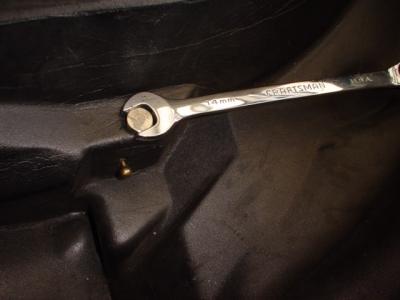

I'm curious to know what this bolt actually adjusts. I hear a (the) noise somewhere around my left shoulder (American-left hand drive). I hear the noise when I hit certain kinds of bumps. Often it sounds like it is in the door - maybe the plastic latch cable-housing rattling between the door and the interior panel?
I tighted the bolt indicated in the picture about 3/4 to one turn. It felt snug (the whole time I turned it), but that could be drag caused by friction in the threads. Maybe I didn't tighten it enough, but the sound is still there. If I know what was tightening exactly, or some way to tell if I've over-tightened it, I think I would have a better idea of what to do. If I tighten it too much (not so much to shear the head off) will something break? Will the top open or close differently? Should I be tightening each side equally? (I have so far.)

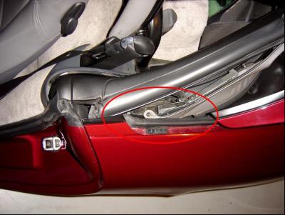

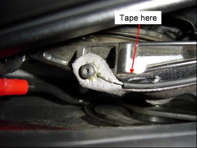

I also had a very annoying clicking / ticking / loose change noise when the top was up or down. It sounded like it was coming from about ear level. I finally found there was a piece of clear tape missing on a small cable guide. I covered the guide up with a piece of 3/4 x 1 inch of clear packing tape and the noise went away for good! Here's how to check yours:
Open the top almost fully so that there is about 12" between the edge of the top and body of the car. Look into the cavity where the top goes, about 6 inches from the end of the door. You will see a red cap on part of the top mechanism. Now look a few inches further to the rear and you will see a cable that terminates on a connector with a star washer and torex screw. Note that the cable is bare for about an inch and then is covered with a black insulator. Right where the bare cable ends you will see a 1" wide thin metal plate that acts as a guide/clamp for the cable. Check to see if there is a piece of clear plastic tape on this. If not, just cover it with a piece of tape and you're in business. It solved my problem and while you're at it, I'd check the other side too.

Per the PM, here are pictures from driver's side of vehichle w/ top opened all but about 12". The torx screw, cable and metal piece are almost dead even w/ the slide tab for the clamshell.
Close up of red circle. You can see the clear packing tape I put on LY is starting to show signs of where. At least next time, I'll know right away where to look and replace. Your existing piece of clear tape is probably just flapping away right there.
Take a look and let me know if this solves your problem
