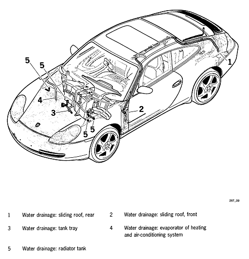

Is your car a coupe? If so, here is where they are located.

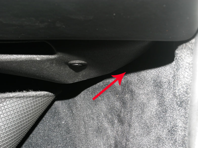

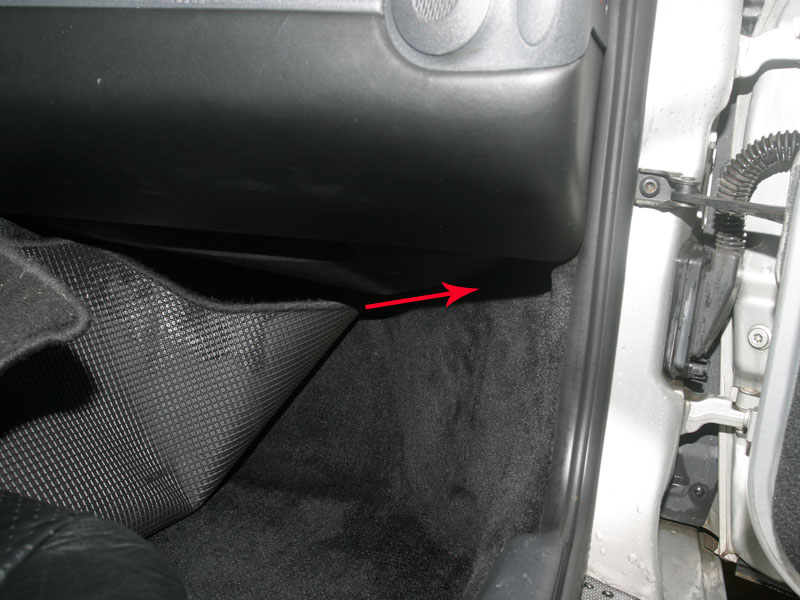

Sorry to bring this subject up again, but I am still having issues with my car getting wet on the passenger footwell when it rains. I have attached a couple of pictures so anyone can get a better look as to what area I am talking about. The tip of the red arrows indicates the "source" of the water. It seems as if it cascades down from the tip of the arrow all the way down to the footwell, but stays just next to the doorsill (all the way back to the passenger seat). I had to replace my AC unit and the drain tube is perfectly connected and draining properly. The drain holes that Loren pointed out on the image above are also clog free. I have no idea how this water is getting there, all I know is that it happens when I drive the car in wet weather. Any ideas or suggestions (besides ripping out the carpet and driving in the rain while someone sticks his head in there?! :o

Popolou: I would agree with you, but less than 30 days ago when I had to replace my water pump, I had the local stealer adjust my windows since they made a lot of wind noise at 80mph and above. Now the same noise is at 120mph, but in both door/window seal scenarios, the problem persists. I am led to believe it has something to do with the A pillar since I have put my hand all over the place and I can definitely track that it comes from above. Notice my first image and you can see the difference (albeit slight) in the "darkness" of my rug. Light means dry (sort of), dark means drenched. You can also see the water deposit on the back of the rug (notice it all stays near the door sill). Any clue as to what is going on?? :eek: :cursing: :soapbox: :wacko:
Loren, there are several threads re the drain cleaing problems, and these pictures are great. I couldn't find any posts or DIY's about how to actually get to the drains except for one regarding the cab tray and access by removing the right rear wheel well cover. Are there other "how to get to" threads? I'd like to check the a/c condenser drain on my C4S coupe, but I'm not sure where to start taking stuff off. thanks, jl

The front drains start in the area in front of the windshield (where the battery is) and exit in the wheel well housing.
The HVAC drain starts in the cars interior connection at the condenser and exist directly under the car.
The sunroof drains begin in the sunroof channel and exit in the wheel wells.
