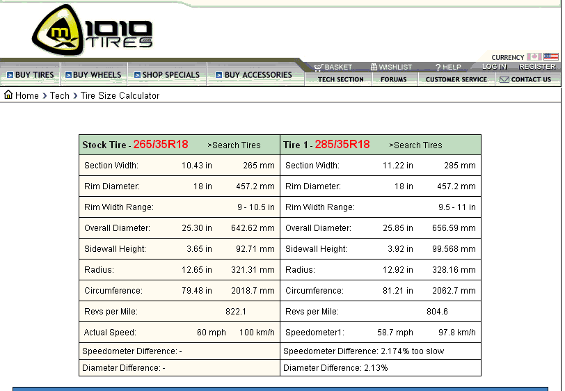

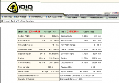

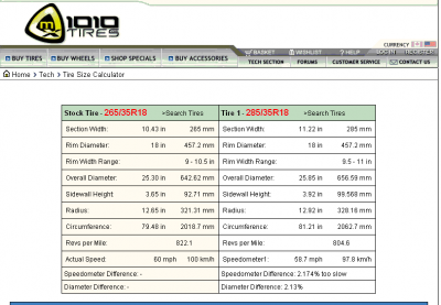

I did a comparison of the 225/265 vs. 235/285 setups. There's a difference but not all that much.
Edited by Loren
made images show
