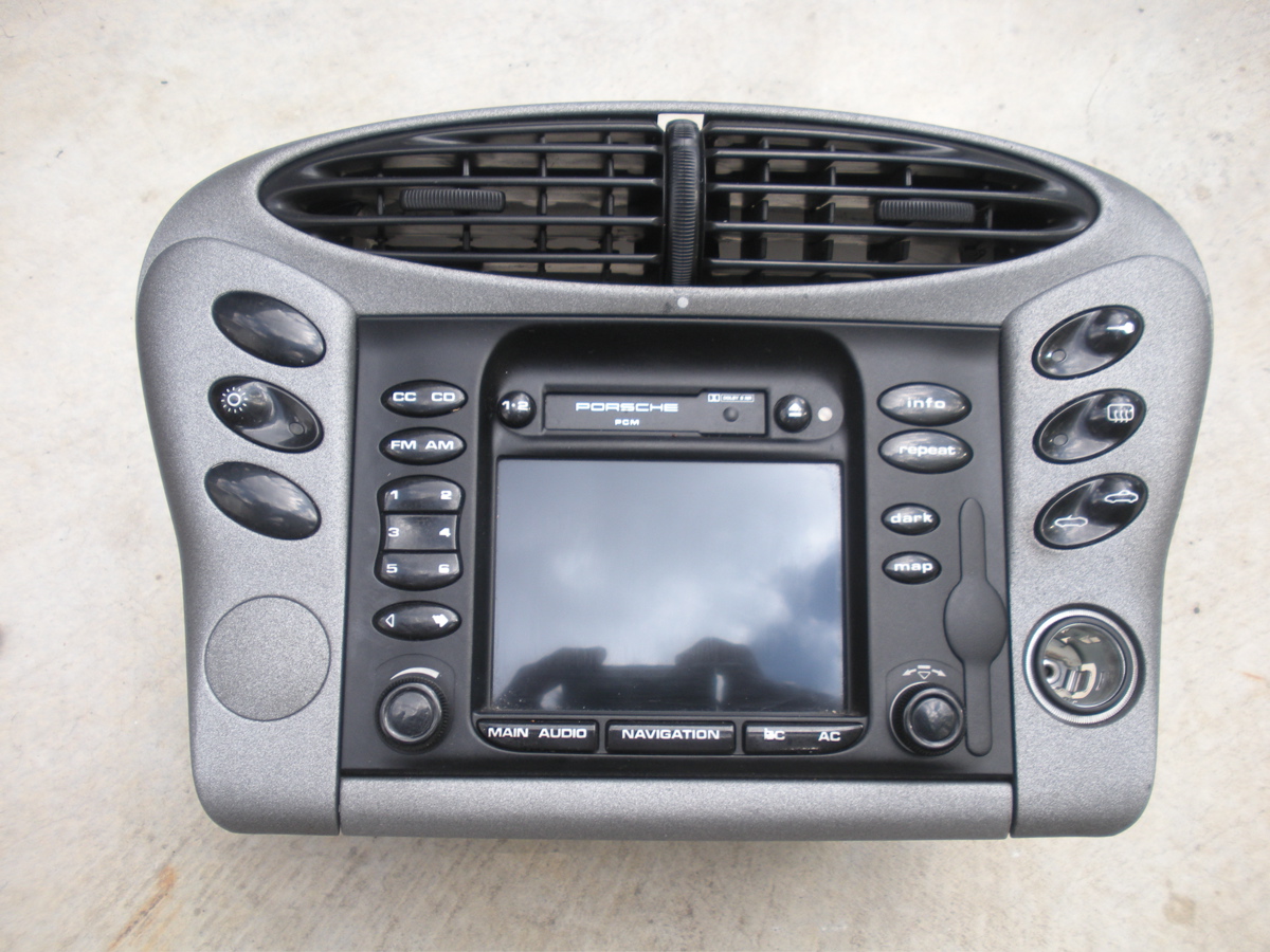

I'm have same problem with 2002 Boxster with double din stereo with Nav & Telephone
Found that 10amp fuse on rear of unit was blown so replaced but still nothing on radio
No display nothing?
All fuses check out ok on fuse panel
Any ideas??
