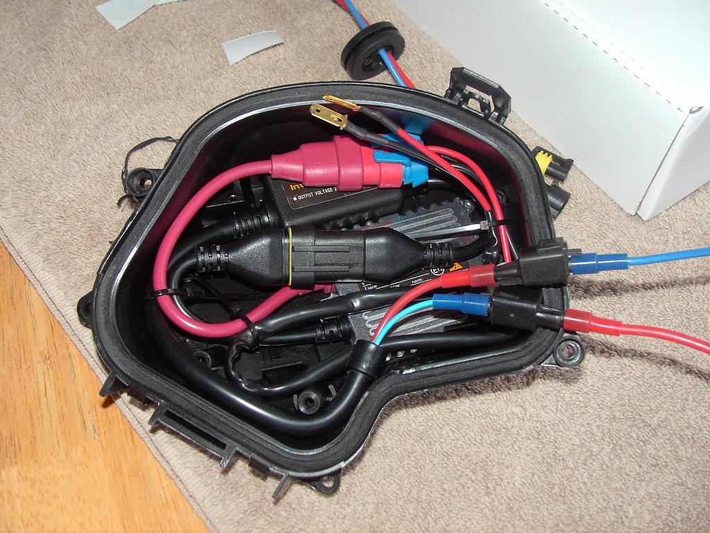

I fit everything into the stock housing, no drilling of the back cover. The only thing outside of the housing is the relay I used to supply power to the system. I used the stock ground and the positive line is fed through the vent tube, a quick disconnect on this wire is all that you see attached to the housing. If you have a 986 there should be no reason you couldn't use the stock wiring, my 987 required separate power to bypass a different problem (see my post).
http://www.renntech.org/forums/index.php?s...c=11244&hl=

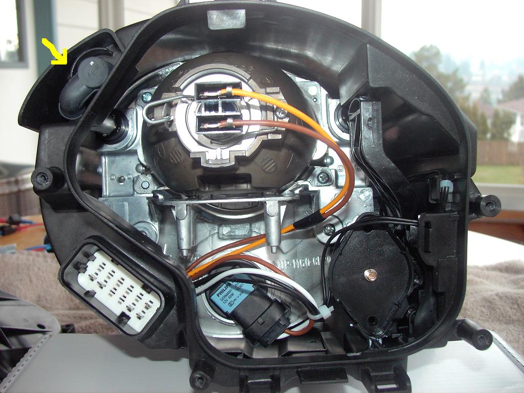

Thank you for the response and for the link, Al! I need to understand what you mean by the vent tube, and (going by its name) whether I will be 'blocking' it if I pass wiring through it. This pic of yours (http://www.renntech.org/forums/index.php?act=attach&type=post&id=8197) is helpful, but leaves me with a couple of questions:
* Is that a pic of the inside (towards the bulb) side of the black plastic cover, or the outside of it? I haven't opened mine yet, but my guess would be inside.
* I don't see any vent tube in the above pic - is that vent tube built into the plastic cover, or is it located someplace else?
Thanks again!

This picture that you refer to is looking at the inside of the rear cover of the headlight assembly, this is the cover that you would remove to replace a bulb or gain access to the internals. With careful thought, some good double sided tape and some small tie straps I managed to neatly mount everything into that cover. The first picture below shows all of the wires and connectors installed, the 2 wires near the top with exposed spade connectors are for power, the black connects into the ground wire of the original OEM socket, the red to the wire to the lead fed through the vent tube and to the relay supplying power from the battery (I used an insulated 'bullet style' connector for easy removal). The blue and red wires to the right connect to the HID bulb.
The breather (vent) tube I am referring to is on the main assembly, it is about 1/4" or 5mm in diameter so one wire passing through it will not completely block it, there is a small piece of foam in the tube (to prevent insects from entering I suspect) that I removed and saved for replacement if/when I sell the car and want to remove the HID kit. (see yellow arrow)
Everything I did to mount this kit can be removed in very short order, my theory is never take short cuts and make it so when things are removed you can not tell that it was ever there. Why take chances on your pride and joy!? B)

Thank you for the speedy response! Completely agree with keeping things as stock as possible. The pics (esp. the one with the arrow) helped a bunch - I am sure my 2001 halogens will be a bit different, but with my Bentley and the pics here I should be able to figure out what goes where :)
