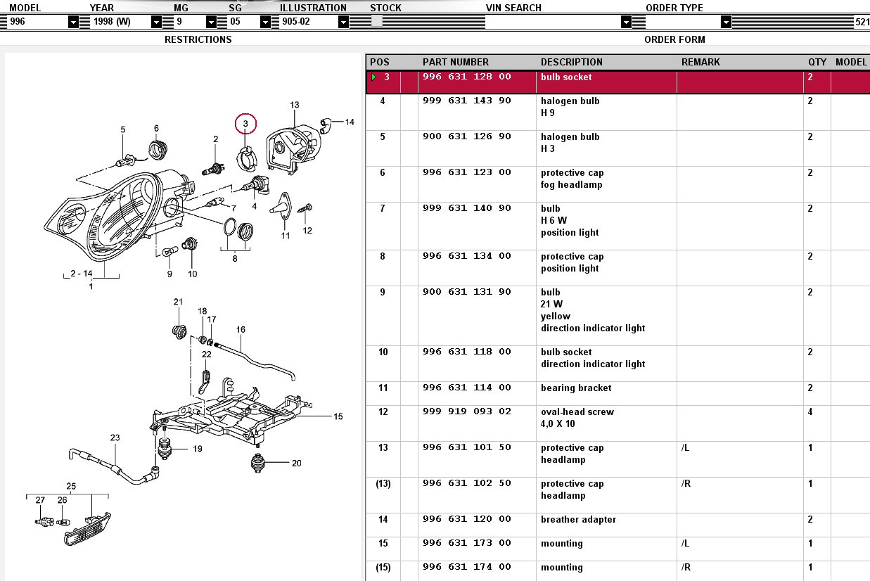

  Tim in MT said:
I ordered bulb retainer rings for the H7's so I can try the xenon bulbs and still go back to H7's if I need t o.
Tim
What's a bulb retainer ring????
  clickman said:
How many 986 owners that have done this retrofit have had electrical issues afterwards? I have daytime running lights in my 01 986. I thought the 987 had the most problems with daytime running lights.
Secondly, I understand most people are doing the retrofit on the low beams. What happens when you use the highs and then go back to the lows? Is there a pause with no light while the xenons re-ignite? If so, how long does it take?
thx Norm
2001 Boxster, 5 spd, Seal Grey
Norm,
Your lows stay ON when you switch to high beams, hence the problem that you envision does not occur.
Bob
I ordered Porche part # 996-631-128-00 from Sunset Porsche in Beaverton , OR. Great people to work with. $4.99 each.
Tim --Too much snow for the car so I haven't tried to retofit yet.
But Tim, what does it do???
Bob
Bob
It holds the HID bulb so I can securely install the bulb into the headlight socket where the H7 bulb fits. My H7 bulb has a quarter twist ring that locks it in.
The HID bulb has no locking mechanism, it needs a locking ring. I will need to cut out the center part of the new holder as it is too narrow to allow the bulb through it. I have a picture of it but I don't know how to post it here.
Tim
