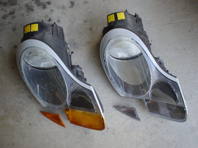

I have a MY00 and there is water in the orange light corners of the headlamp. Should I just replace them with clear ones or is there a way to drain it out? How do I make sure this does not happen again?

If it is the corners/reflectors in the pic then the water seal has failed. If you did not know, the corners are a separate part from the headlight itself.
The fix is to replace the corners.
Thanks guys. I have to replace it then Toolpants, cause' I have about a cup of water in the corner lights! Thats more then a little... LOL
