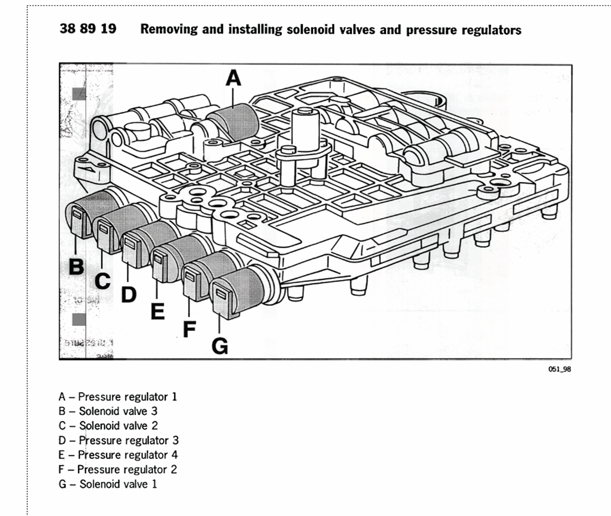

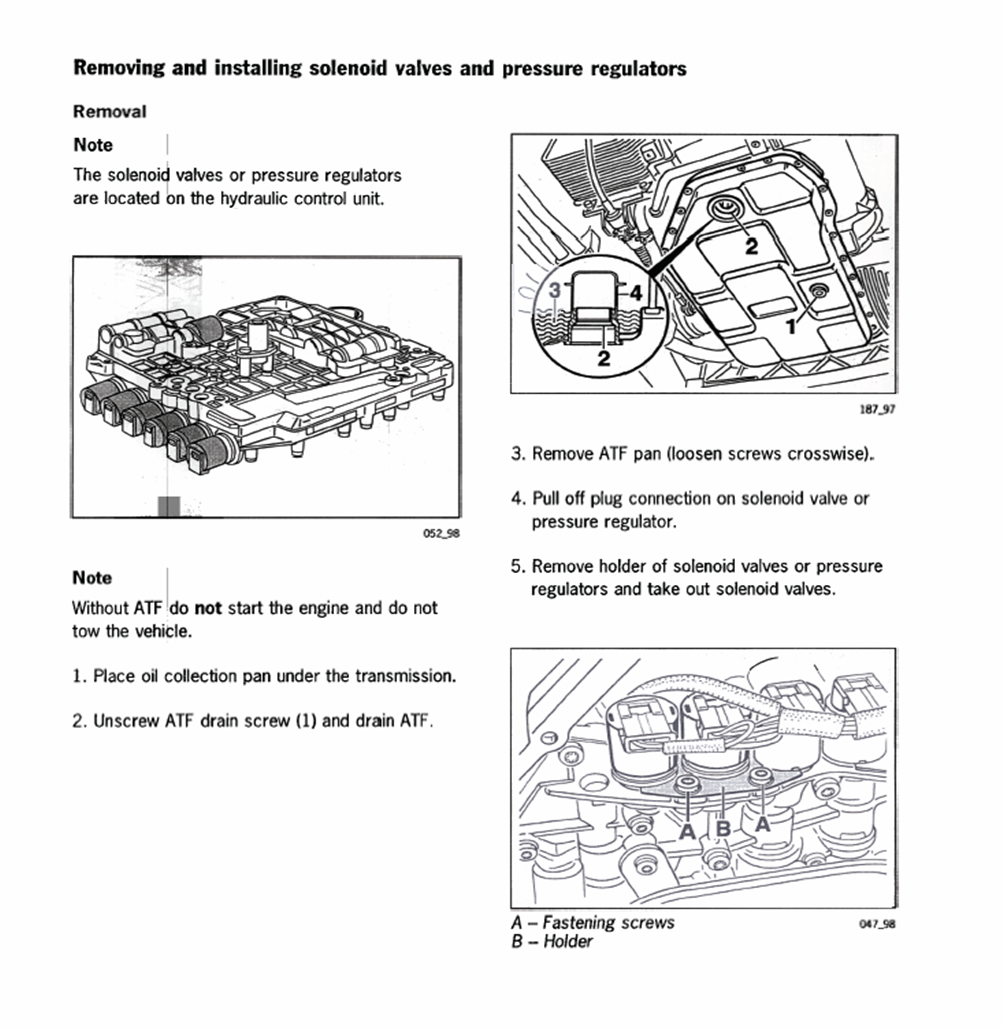

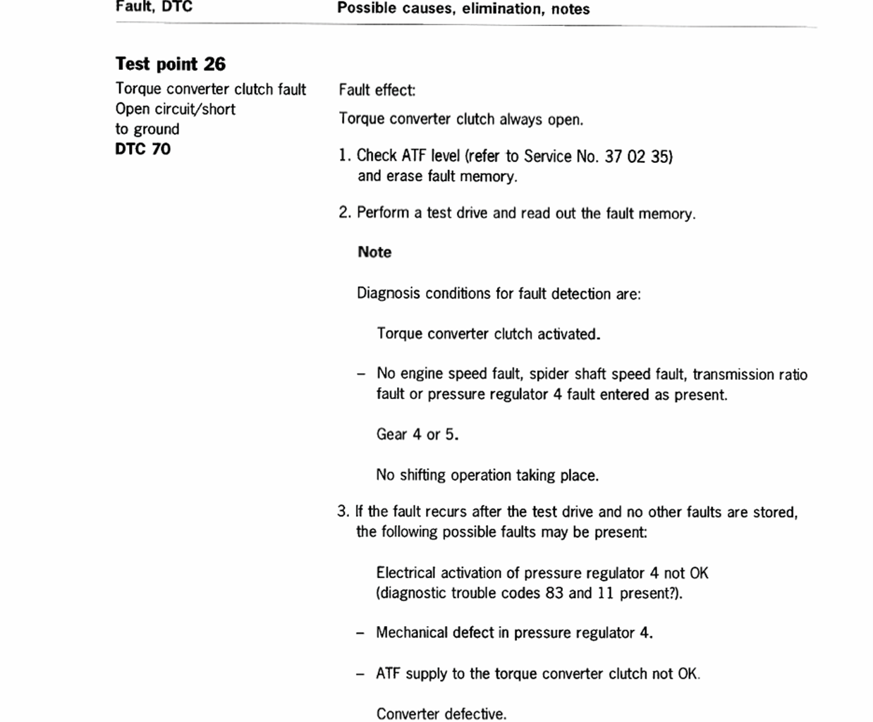

Here is the fix for code 0740 on Tiptronic. After refilling fluid (by the dealer the last time), the code would come back after 100 miles or so. The potential fix from Porsche was a new tansmission, around $7K. Before I spend that kind of money, did some research that lead me to the following for P0740 code:
Since the fluid was changed, went to step 3. Here is the location of the pressure regulator and how to remove it. You have to drain the fluid and remove the ATF pan to get to this part, then it will be obvious. There are ATF filter change instuctions in the DIY that will help with additional detail.
Part number is 986 352 603 00
I know, it is a Boxter part, but that is the part listed for the 996 too. $220 or so in my hands, easy install. The only difference I did notice post install was how much quicker the transmission will shift upwards. For example, 5th gear could come at 38mph, before the fix it was 48-50mph. Short of that, same smooth shifting. And a heck of a lot cheaper than a new tranny.

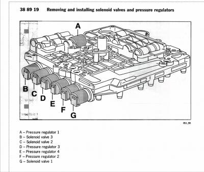

I ran across this post. What timing. Hope some one is still on it. Been dealing with the 0740 torque converter lock up code.  Since I am in Ca. It will not pass smog. Car runs great. It’s an O1 986 S. Have had it almost 20 years. I too love this car. I think I found the part number  for the solenoid but not sure.  986 325 601 00. Getting up there  in years so the getting at is getting tougher, but doable. Would appreciate any help given. I see from this post the part number I have was incorrect,  but which one is it? ABCDEF or G?
This is a 10+ year old post so part numbers listed may very likely have been superseded.  I would call Sunset, give them your VIN, and order the latest part from them.

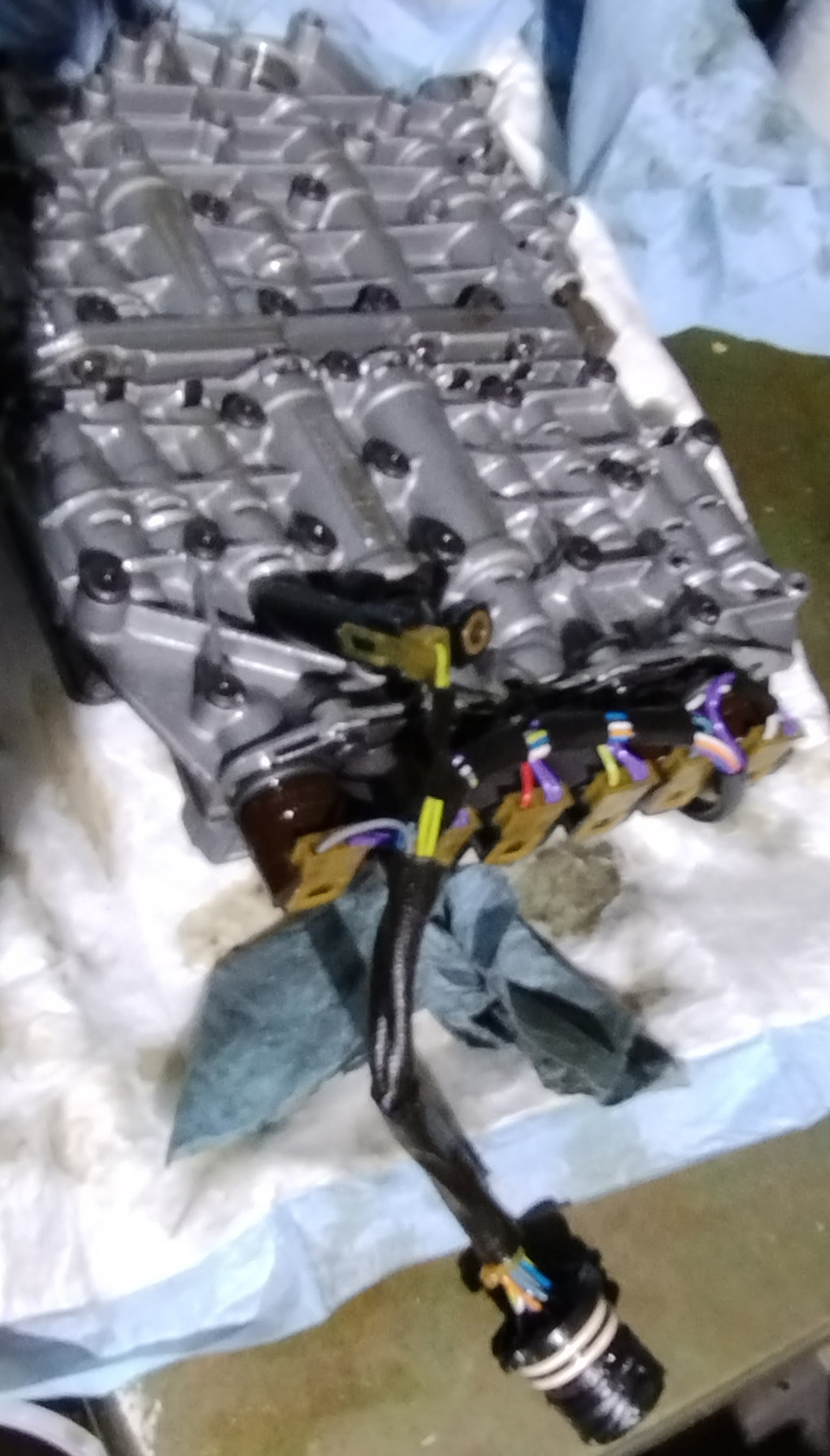

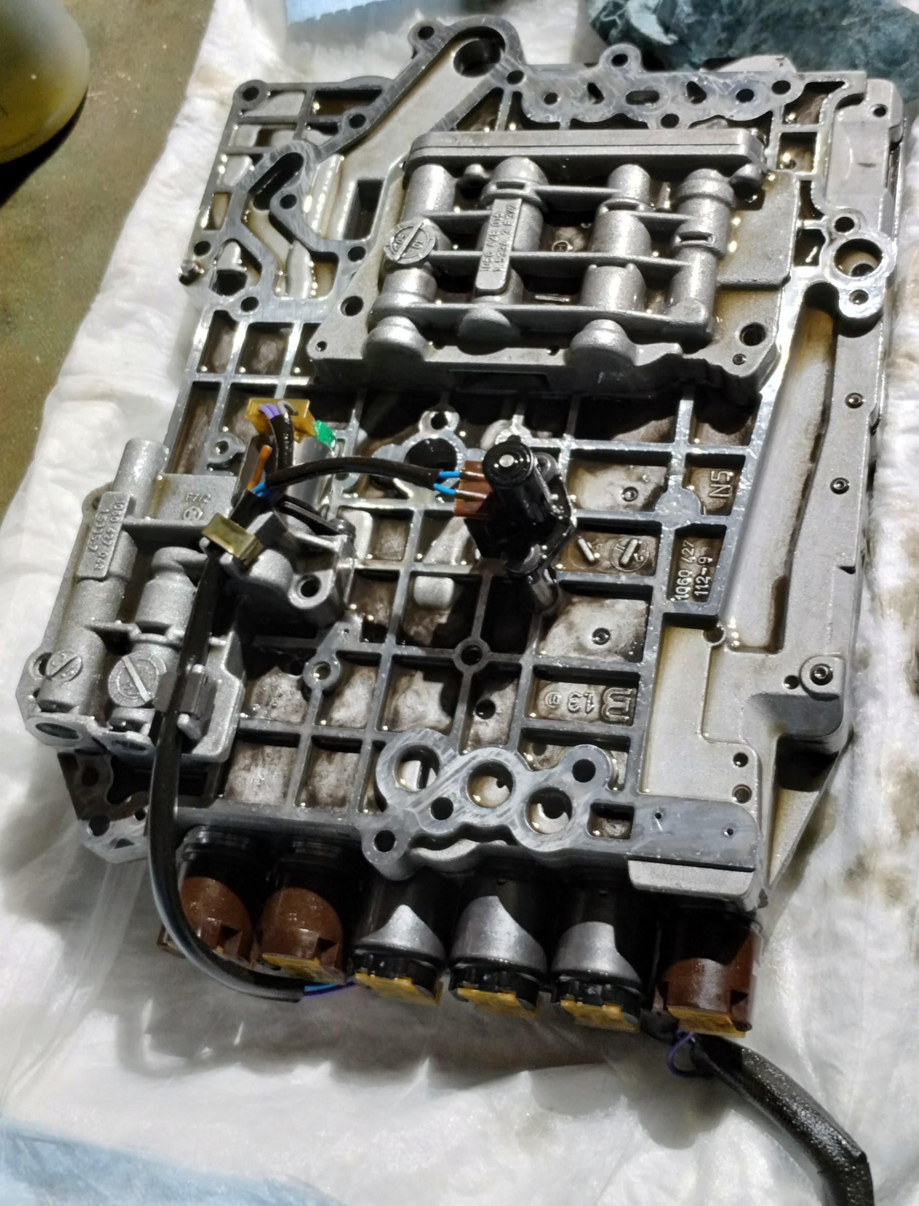

Short Story and Current State:
  • I ordered a ZF solenoid / regulator kit, carefully replaced all 7 parts and had one new one left over. I'm curious as to why there was one left - Is it supposed to go somewhere else?
  • Now, I'm only getting the 0740 and a different, more basic stop light switch signal that comes on occasionally and kills ABS when it does.  That may be a red herring.   Will try another switch.
  • On the fluid: I filled with Pentosin, started the car and ran through the gears.  Then I stopped, checked/refilled, and ran through the gears again.  Then, I checked/refilled it and drove it a bit to make sure the fluid got everywhere it was supposed to get before a final check at the proper temperature.
  • The only symptoms I'm getting in the transmission are somewhat abrupt shifting, mainly into 3rd but sometimes maybe into 2nd.  I've tried the quick 3 pumps of the accelerator trick and that does alter the shifting.  I'm not sure it fixes it, though.  Sometimes it seems less abrupt, but I haven't nailed down that scenario yet.
  • I haven't had the shift points recalibrated, so that's a potential action.  Any other ideas, insights, etc.?

  • I dropped the pan, put in a new filter, and filled with a Febi product that is supposed to be proper.  I also changed the fluid in both differentials.
  • The initial fluid that came out was dark grey as I recall.  In the bottom of the pan was a bit of sludge but I didn't see any metal shavings when I cleaned all the magnets.  Once back together, I started noticing the 3rd gear revving up unusually at times so didn't drive it much while I researched.
  • I made the mistake of putting a gasket varnish/sealant on the new pan gasket, the kind you paint on. Apparently it didn't seal too well. After noticing significant leakage, I once again dropped the pan to replace the gasket, and filled it back up. I didn't see any seal or sealant fragments in the pan. That time, I used Pentosin.
  • It seemed to get worse after that, though.  Still slipping in 3rd and then limp mode started popping up.
  • At this point, I took it to a Porsche tech I trust.  He said I needed a new valve body for only $5400 + installation.  Ouch.
  • I pondered sending the valve body off to be rebuilt, but decided to try the ZF solenoid and regulator kit instead after talking to both that shop and another.  That takes us back to the short story at the top.  Very drivable, but need to figure out the P0740 before declaring it road-ready.
