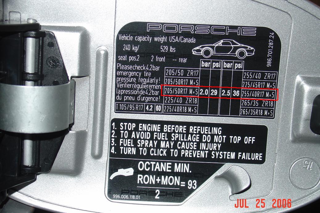

Thanks for the response Brian. That is where the confusion originated, I checked the owner's manual and it recommended the tire pressure you listed, but when I checked the fuel door it had a column for rear tire sizes and one for front tire sizes and the only tire size that had the 29/36 psi pressures were 205/50 r17 and 225/45 r17 respectively. I guess the question is do the pressures listed apply to all the tires listed on the fuel door? Thanks, Raul

Well, I guess I'd like to see your sticker to fully understand where the confusion originates.
This is mine (2003 986S):
This sticker lists numerous tire sizes/types, depending on what came as standard equipment (the ZR17 tires), optional equipment (the ZR18 tires, standard on my S), or special equipment (i.e. the 17" and 18" M+S tires). Your sticker may vary, depending on model year among other things.
All the road tires listed on that sticker above are to be set to 29 psi (front) and 36 psi (rear) respectively. (The temporary spare is an exception, which is to be set to 60 psi.) This also corresponds to the information provided in my owner's manual.
If your sticker looks like mine, is it possible that you are interpreting the table to mean that 29/36 applies only to that very row of tires? In other words, are you looking at it like this?:
(Red box added for emphasis.)
If that's how you are reading it, I see your confusion. The table above is correctly interpreted by applying the pressures to the other rows of tires as well. Hope that helps.

Brian, thanks for going through the trouble of taking pictures and providing an in-depth explanation. I also have an MY 03 just like yours and yes I interpreted the sticker to apply to that particular row. Don't you agree (at least a little bit) that it could easily be interpreted to apply just to that tire size?
