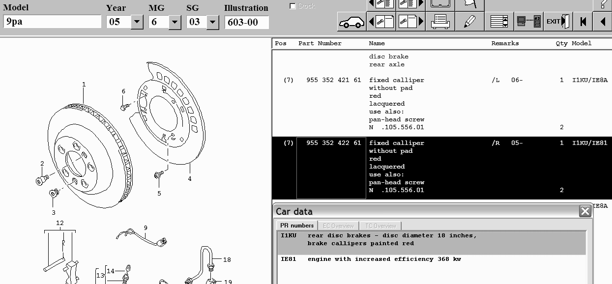

I was thinking that maybe he sold me the rear calipers that were part of the tequipment turbo power kit package.

2005 TT. I have the part #s for the calipers I received, they are 955 352 422 61 and 955 352 421 61. Do you have the part #s for the correct one I should be receiving? Thanks!
Thank you! I have opted to place these rear ones on sale on ebay.
I called the dealer and they gave me this part # 955-352-421-50 and 955-352-422-50. These are the right ones for a normal turbo correct?
Correct.
