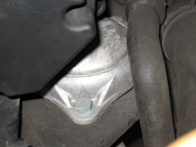

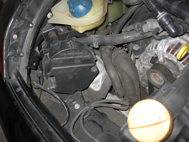

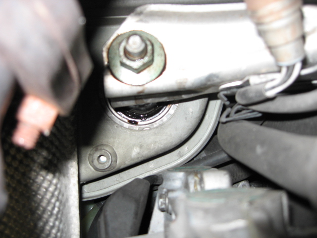

So I go jack up the back of my car so that I can swap mufflers....I lifted the back end pretty high so that I can have good amount of room to take the mufflers out. All of a sudden I see oil dripping down from this area, a total of a few table spoons:
This bolt is directly below this silver cap thingy:
Here's a close up:
What is that?

Most likely oil leaked from above onto the shelf of the bracket. When you lifted the car, the angle increased enough for the oil to drip off the shelf.
Edited by 1999Porsche911
Possibly the fluid from the engine mount. I think they are fluid damped and the fluid looked really clean in your photos.
It was sorta like engine oil, but then again it did have a funky smell to it. Kinda like old rubber.
