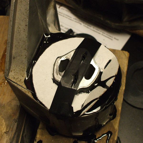

Ok, so i've made my jig, cut out templates in cardboard that will align center portion of mount.
any thoughts on efficiently removing all the rubber?
A dremel with a small wire brush will quickly remove all rubber, while leaving a slightly polished finish on the aluminum.
Ok, post surgery report...
i had to get the Flexane 94, no one had 80 for several hundred miles.
take your time when preparing for the pour, really make sure you seal it up on the bottom.
the ride is stiff, the throttle response is definetly improved. the vibrations on the other had are a little much for my wife, it feels like a race car which in my mind is awesome, but it is a little harsh for daily driving.
i may redo a mount with the 80 to see if it is any better.
anyone have an old mount they would like to sell?

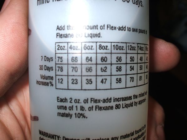

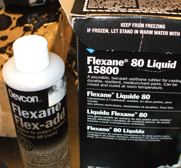

Hello.
For those of you in process of using flexane, read this.
My engine mount was completely destroyed, and off position. :cursing:
After reading previous post on the hardness of Flexane 80 and Flexane 94, I've done some
research on this product and found that they've created a flexible product that reduces hardness.
So, I've rebuild the original engine mount with flexane 80 but I've added Flexadd to the mix
to reduce the hardness to 70 (more similar to the original rubber)
This mix was great, I don’t have any vibration from the engine and flexane is holding great.
The Flexane 80 and Flexadd were bought from Markingpendepot.com
Good luck

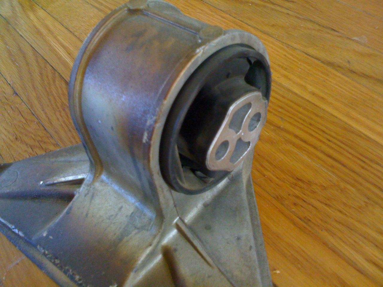

I potted an old, torn motor mount for a friend with Flexane 80. We followed the instructions to a "t" and the motor mount failed after less than a year in service. The Devcon didn't bond to the Porsche rubber (even properly degreased, cleaned, dried and roughed up and given proper time to cure at room temp). I'm not sure what I did wrong, but I tried the Devcon repair on two motor mounts and neither one of them lasted in service. They eventually developed a nasty vibration around 3,000 RPM which forced us to remove the mount and find that it had separated again.
Ordered a new mount and found that the part number has been superceded to a 987 part number. 987-375-023-04. It is far more robust than the old 986 mount. There is more rubber connecting the inner metal of the mount to the outer cylinder. Also there is more rubber in the void area, meaning the mount can deflect less under heavy loads.
The new part was only $140.14 from Sunset.

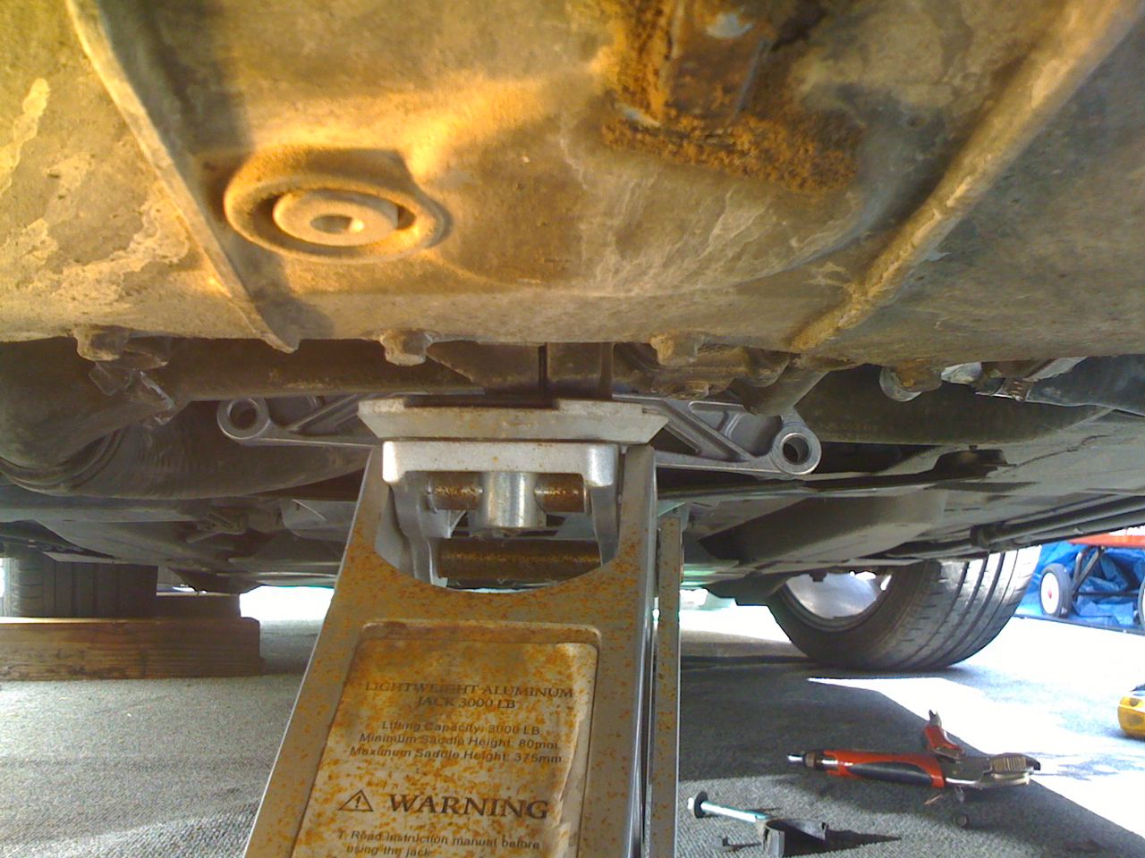

My apologies for adding to this old thread but I'm seriously envious of everyone who managed the engine mount replacement with minimal trouble. I have not been so lucky and am looking for some help. Witness the attached pictures. With my new mount bolted to the frame I am now about an inch away from lining up the mount with the engine. Examination of the old mount shows that not only was the rubber seriously torn from the mount but pushed heavily to the left side of the car. (When I say left or right I am looking forward from the rear of the car).
UPDATE: I installed the frame mount upside-down. This is what happens when you don't do the job all in one go. Car now back together with minimal fuss. Next time I'll take pictures during the entire process for reference. Of course there will be no next time because I hope I die before I have to spend that much time underneath my own car cursing myself.
-bill
1998 Boxster 2.5.
Edited by pricebill
Get a good flashlight and go look to see what you're doing. I just did mine, and did not have any problems, although it takes a lot of fighting to get it in/out since there is just no space.
If you think about it, the bolts fit/lined up before, so the the new mount should similarly go back in. Some advice I learned part-way through the process is do NOT do the lower bolts until you get the upper bolts in.
Good luck!
