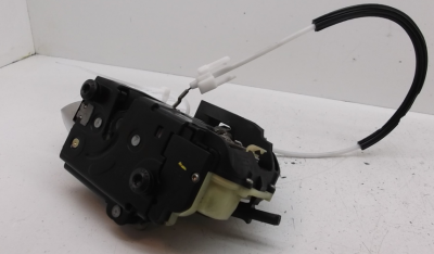

  1. Hello All, the switch INSIDE my passenger door lock mechanism failed, the one that tells the car wether the door is open or shut. I replaced it with a used unit that seemed to be the correct part. (see the attached image). After the installation of the new part, I closed the door, and then nothing will re-open the passenger door. Both handles won't work, even with force and banging on the inside. Locking and unlocking repeatedly won't trigger the door handles to successfully open the door. I've disabled and reconnected the battery, and nothing. I took the door panel off while the door was still shut (which was no easy task). This is where I'm currently at. I can't take out the door lock mechanism to put the old one back in because the bolts to take it out are on the outside of the door, which is shut. Does anyone have a good idea as to how to force the passenger door to open? I fear the mechanism I got wasn't for a Boxster with the M535 alarm, and the car doesn't understand that it's there, and therefore won't unlock it. I can revert to my old unit as long as I can get the door open. Does anyone here have thoughts? Any help would be greatly appreciated. - Matthew
