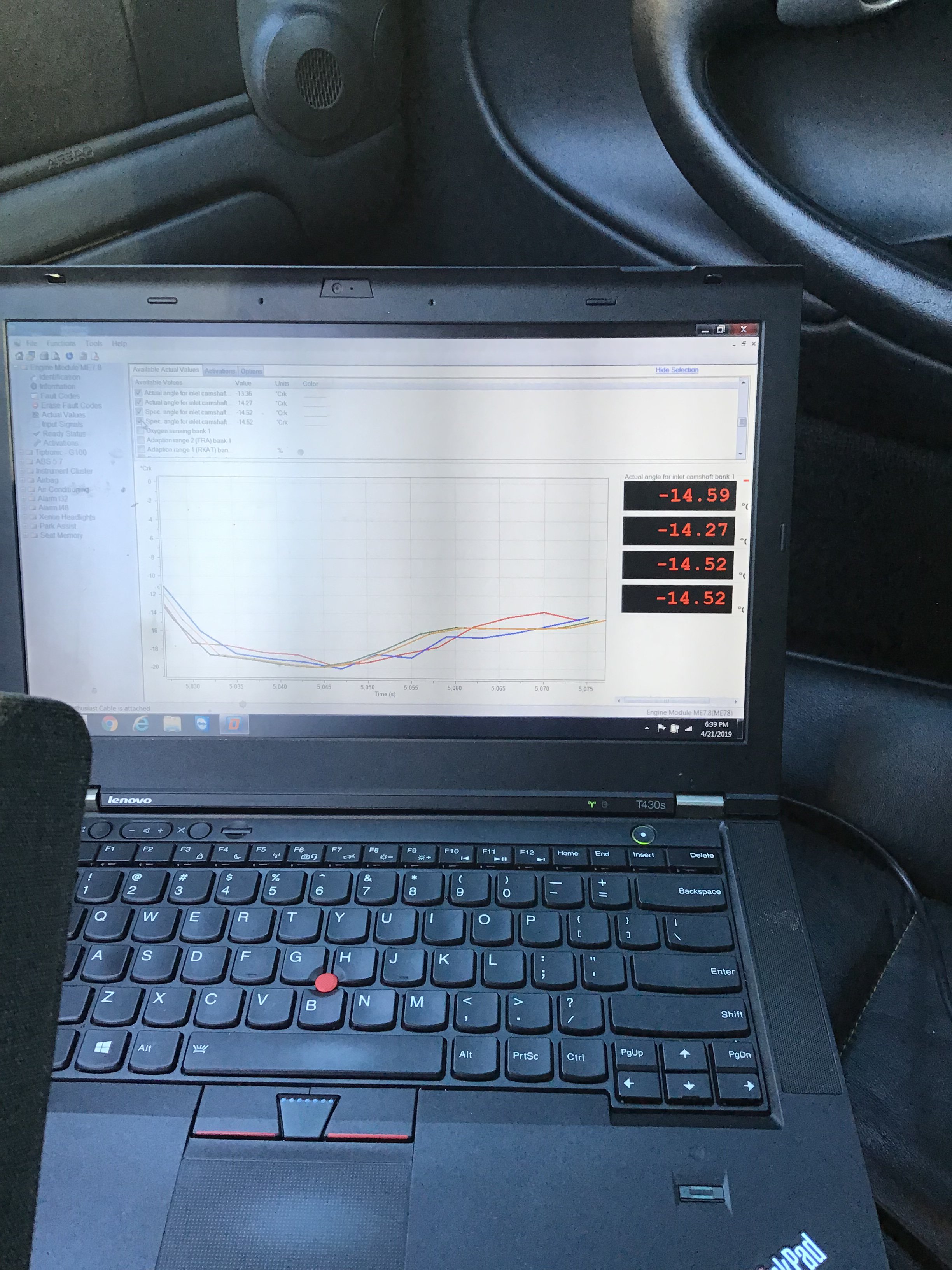

  4. i got some new codes this time p01362 and p01371 how can I Diagnose further with durametic

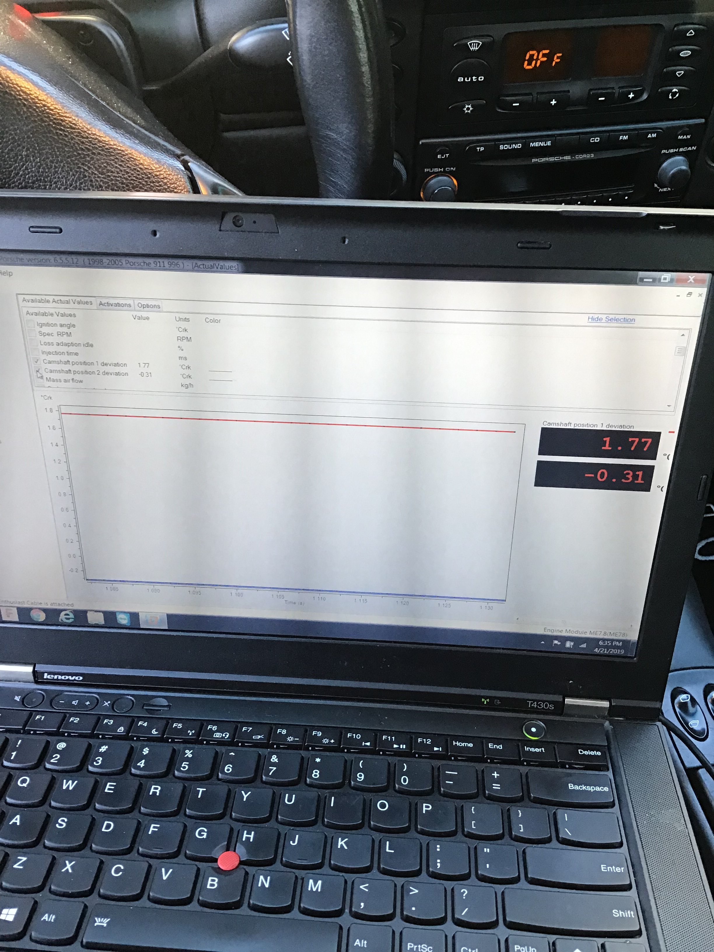

  5. I’ll look at cam deviation in durametric .If I run rpm up it clears up and runs fine . Does not make any noise like lifter or broken spring . Thank you Ahsai for your input
